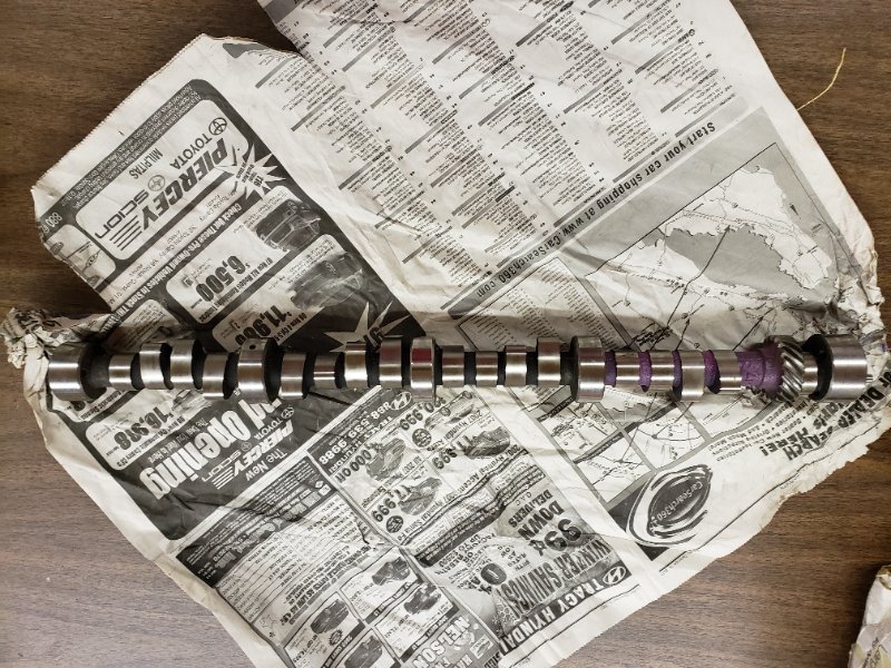

I was digging around in a box of parts and ran across this 2nd cam (first was a small block cam). I'm having a bout of CRS (Can't Remember Stuff [sic]) and need help identifying what I've got. Best I can figure is it's a MP purple shaft based on the obvious color between the lobes but beyond that ????? Please take a look and see if you can help me. Thanks.

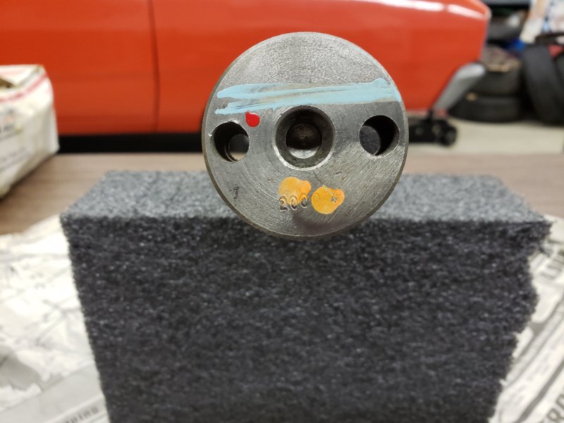

What I see is 200038. Usually MP cams are something like 4120231 or some such so it's the right amount of digits, just WAY off for a Mopar cam. It LOOKS like a Mopar cam though. Their lobes are never parkerized (black) that I've ever seen.
Oh, it's definitely a Mopar cam and you are correct on the 200038. The lobes are not parkerized - maybe it was the light or angle of the camera that cause them to look that way.
The later model Purple cams were not Parkerized
But the early ones were
I still have an old NOS one on the shelf
The early ones only had a slash mark of purple at the rear usually
Not painted between all the lobes like later
Tommy
I've never seen a parkerized Mopar cam ever and I've been using them since they were Direct Connection. Now what I have seen parkerized was the cams that came from Racer Brown for Mopar. Those were all parkerized as far as I know.

From what I’ve read, the “paint dab” era MP cams were sketchy at best as to whether they were actually what the paint dabs suggested they were(there was supposedly a paint dab legend).
That from someone who worked for MP.
Imo, if one really wants to “know” what the cam is, it needs to be measured.
Yep there's no real way to identify a lot of purple shafts. Like mentioned measure your Base circle and your lift do the math and it'll tell you.
Yeah I'd send it to Oregon. Ken Heard will be glad to map it.

It's ok. I was just letting you know. But do like I suggested. Call Ken Heard at Oregon Cam Grinders. He's a great guy and will give you a fair estimate on mapping that cam and sending you a cam sheet on it. That way you'll know exactly what it is.
Yes, Ken mapped a General Kinetics 590 cam for me a couple of years back. I was hoping someone here with more knowledge than me would recognize what it was. So, it's off to the shop and box this up for OCG.

Since the MP cams have different lifts for each grind(and 1 bolt for Hyd/3bolt for solid), I’d just measure the lobe lift with a caliper(biggest minus smallest), and multiply that by 1.5, and whichever is closest…..should be what the cam is.
Of course, if you really want to know the nitty gritty, it would have to be mapped out.
