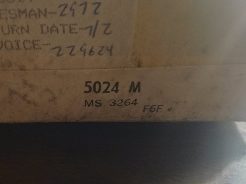

I found a set of new (but old) TRW mains in my attic and it's written on the box "MOPAR SMALL BLOCK STD MAINS" part numbers are 5024M and under that is MS 3264. Are these 360 or "except 360"?
And by the number are they steel, steel/babbitt or tri metal????

Ive looked and closest I could find (definitely newer stock) was 5024 MA. There's definitely no "A" in the PN stamp on this set

TRW main bearing set number MS3264 fits 1974 (after engine date code 812) - 1991 318 engines with 3.530" maximum flange bearing outside diameter. Prior maximum flange bearing outside diameter was 3.374" The set consists of the following individual main bearings:
- MB2035 (three)
- MB2559 (one)
- MB2620 flanged thrust (one)
These bearings are TRW "Micro" or steel backed babbit construction.
Part number 5024M is the Sealed Power/Federal Mogul number.
