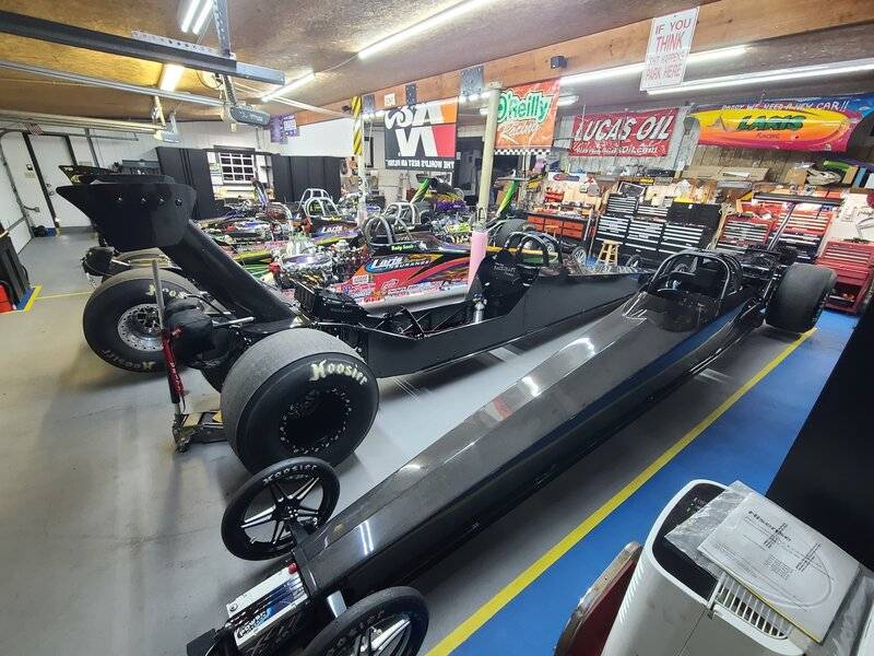

The box I was looking at is the Ultra plus. It was the only one that had a boost reference port. It had multiple timing and rpm settings, as well as what appeared to be a "launch" timing curve, and was bluetooth programmable. At the trade show it was advertised at $430, which I thought was very reasonable. I am in charge of a 5 car NHRA drag race team, and we use the MSD Grid system which also has the launch retard. I use that feature extensively to control the hit as well as overall ET. We run TopDragster class, and are not allowed to run faster than 6.10. So I use the launch retard to ramp in timing off the line.
Yes, that is what I thought as I had found a table that showed the features of each of the Ultra models and the Ultra Plus appeared as you described. @ $430 that's a good deal and is roughly $100 less than the PO.I. distributor with nearly identical features. Certainly parts and service would favor the MSD unit over the P.I. distributor.
Your job must be hectic at times but really enjoyable for a gear head.
I would rather be working on Mopars, but,yeah it is a great job other than that! Lol
