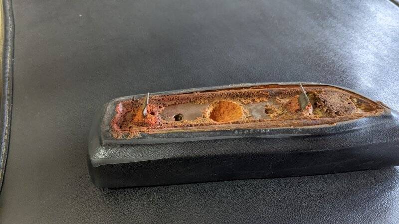

This is stock (67dart)
Barracuda should be the same.
The metal is riveted to the plastic
The pad has spring steel tabs that snap in.
( The ABC pads look nice but I have not had good luck snapping them in. The spring steel is too brittle)
I recall someone saying that the aftermarket arm rests require screwing the pads on before installing the armrest plastic to the body.

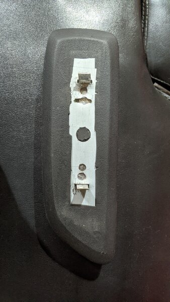

I needed a replacement for my 68 dart convertable
(barracuda is the same)
The replacement screws into the quarter trim. You have to take off the interior quarter trim to install it.
The ones from ABC are more professionally made, sorry Layson!
I got mine about 5 years ago not sure if it's changed or not.
ABC doesn't show the underside so it's hard to compare.
The butchery is from me making tabs that don't break.
But you could screw them on easily.
It looks like they are now made with an injection mold process.
Mine must be an old way of making them.
I think I paid about $30. for the one.
Now you can only buy them in a set.
