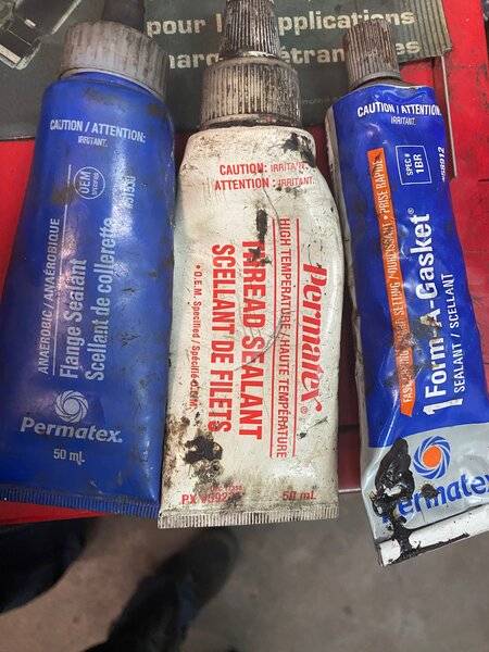

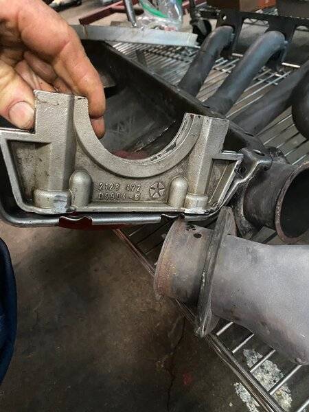

for the rear main seal I grease the lip, scotch write the crank. and I use flange sealant its a rem jam like paste. at gm I used it for rear main sealcaps so it would leak out . I have a spare rear flange like that
and I use right stuff silicone to stick the rubber oil pan seal to oil pan and use that and bolt it to pan overnight so it stays in place . so if you don't have one I would do that first then assemble the rear main seal. and also use a bit of Silicone to seal the oil pan after.

I light sand the plug and use permeated forma gasket 80003 ( fast setting hard drying)1C
the oil gallery plug I use the pipe sealer paste on it.

these are the stuff I use, I showed a picture of where I put the flange sealant, I always use in , I did a alfa Romeo engine and they leak from the flange of rear main , she borne dry I did it like 6 years ago, and plenty of 3.8 gm engine. and I would defiantly use the rear main insert to silicone in the oil pan gasket.
good luck
good luck
good luck
so you dab flange sealer on the rear main seal and in the flange, and the L tabs, then torque it to specs.
