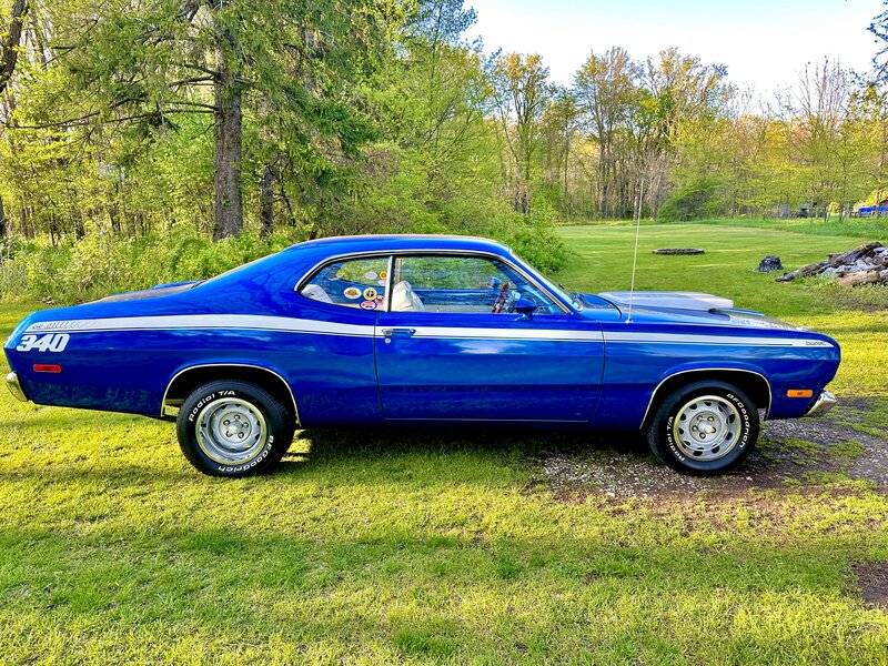

just be warned...the shock mounts were not designed to carry vehicle weight, only transient damping loads. when we bought my duster when I was 16 in 1991, the car had air shocks on it and both shock mounts were ripped out of the floorpan. it only had 50000 miles on it.
your mileage may vary, buyer beware, etc...
Very nice look!

I run 245/60R14 all the way around. Like the rotate advantage and 1sz spare. Right front occ rubs on right turn with full load but minimal.
Yup! An little passenger side rub on turn here too.
