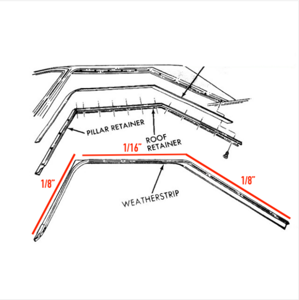

Where did you get your seals? The ones I bought from DMT (Steele) fit in pretty easy but didnt seal well until I shimmed up the backside thickness of the rubber. The seal was loose in the roof rail groove. Kind of hard to explain but you could grab the edge of it and move it up and down within the groove. This extra play didnt keep the seal pushed tight against the areas where it makes contact with the door and glass. It was touching but wasn't tight which created some wind noise and allowed a little but of water to get around the seal during car washes.
I bought a few different rolls of 3/4" wide weatherstrip with adhesive backing. The thicknesses I bought were 1/8" & 1/16". I used a combination of those two thicknesses to get the seal fitting more tightly in the roof rail groove. I used 1/16" along the front edge of the vent window, 1/8" along the top of the window and then back to 1/16" above where the quarter window starts continuing all the way back. Stick the weatherstripping to the back side of the rubber seal then slip the seal back into the roof rail groove.
