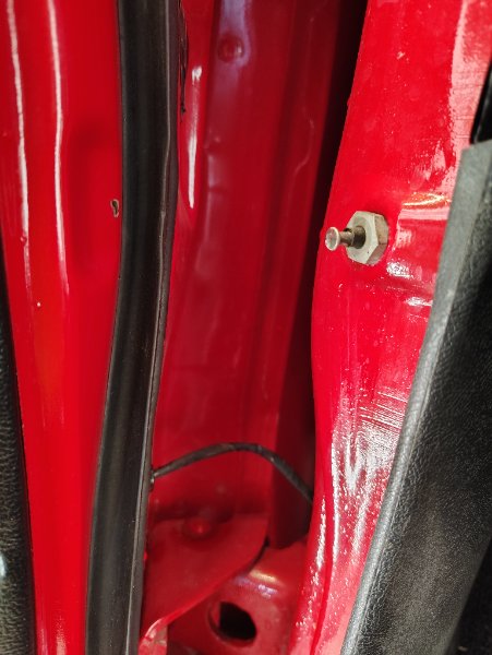

I used the ones Dustermike linked to run my power window wiring into the door. I’ve seen the ones Kendog kinked but decided to go with the other ones. They work great
FWIW the power window wiring is at least 12 gauge. The wiring sheath I used had room inside for the PW wiring but not enough for both the PW Awiring and the power door lock wiring.
hmm ok. at least someone has used the ones i shared. i didnt even think of those contact style ones you posted jetnoise. ive worked with something similar.
they look like this but always had issues with them breaking.
I put power lock on my Dart when I restored it in the late 90's. Wrapped the wires in the same loom wrap Mopar used, snapped in a plastic grommet in the fender and door to route it through.
Go to a pick apart and find a car with similar gap and take them, i think rubber would probably work better an less chance of kinks and stiffness.
The ones u linked look nice however
