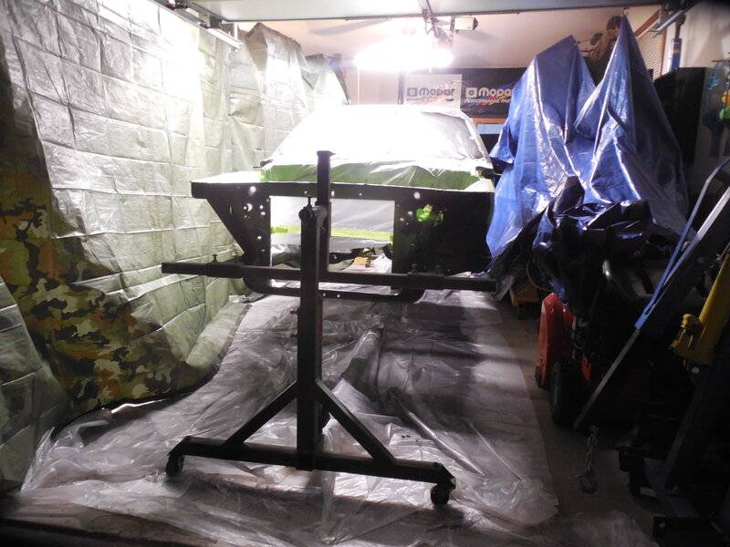

See if you can rent a rotisserie? That way you can rotate and not have to lay on your back. Don't forget the ppe. Be organized cuz bare metal will flash rust asap.
Do not use sand use crushed glass . Smoother finish and not as much heat on the panels. Try both at night and see the difference. Not Glass beads, Crushed Glass. I spread a rubber truck tarp, Lift the ends so it gathers in the middle shovel it up and then sift and reuse the material. Always trying to save on consumables. Heavy plastic and a lot of duct tape. Install old parts in the holes to seal the car and blast away

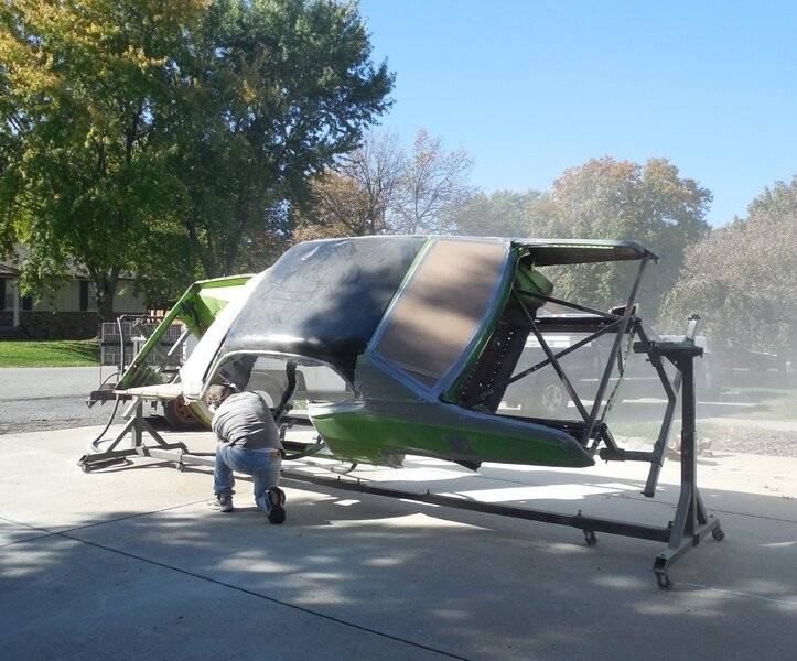

I hired a mobile blasting guy for my Duster and he used the crushed glass on it. I think it cost me around $600 total and the guy did an excellent job! That said I wasn't blasting the entire car just the inside and the bottom of it as I wanted to keep the original patina paint. It helps that he was a car guy himself so he was extra thorough. Once the guy was done blasting he also used his industrial compressor to help blow out the remaining media. After he left I flipped the car back and forth on the rotisserie cleaning more media out of it with my compressor and leaf blower. Then I rolled it back in the garage, prepped it and shot epoxy primer on the bare metal sealing it before it could rust. The biggest PITA was cleaning up all the media from the drive way. Thankfully I have good understanding neighbors!
I have done similar home blasting, but I built a PVC and plastic sheeting cover over car to better contain/reuse media.
