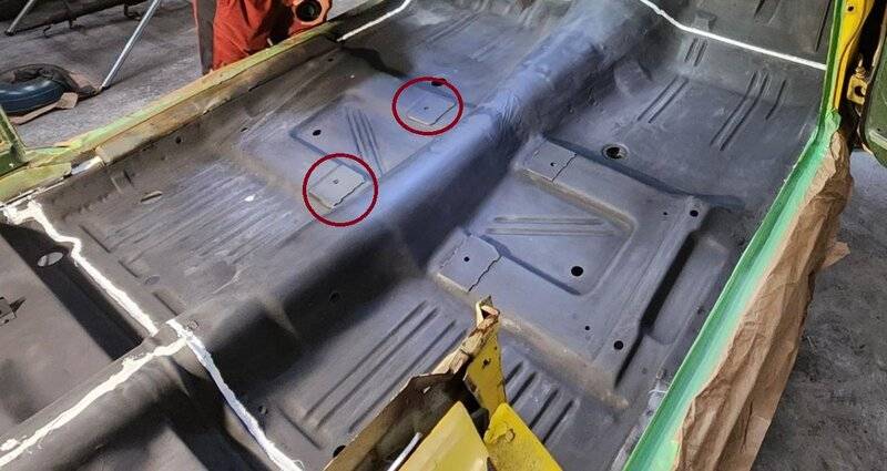

I will have to drill at least two holes for the inner sides cuz i had to install some janky *** floor pans cuz the AMD 1 piece has been out of stock backorder no return date for 2 years. But im not afraid to drill holes. when i did my 70 dart i drilled like 4 sets of holes cuz i was young and didnt take my time and kept messing it up Lol.
Seems like you need to add a floor doubler to the inside floor holes for buckets.
