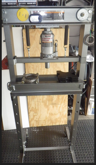

Looking at the hobo freight shop presses, see they have a 12t and a 20t. This will be used for basic work like front end bushings, bearings etc., will I need the 20t, is it built better etc?
I have their 12 ton press, and have been using it for years in my rebuilding of lower control arms, and other automotive type of press work.
The 12 ton unit has been more than adequate for anything that i do suspension wise.
I think that's all the tonnage that you need. 12 tons.

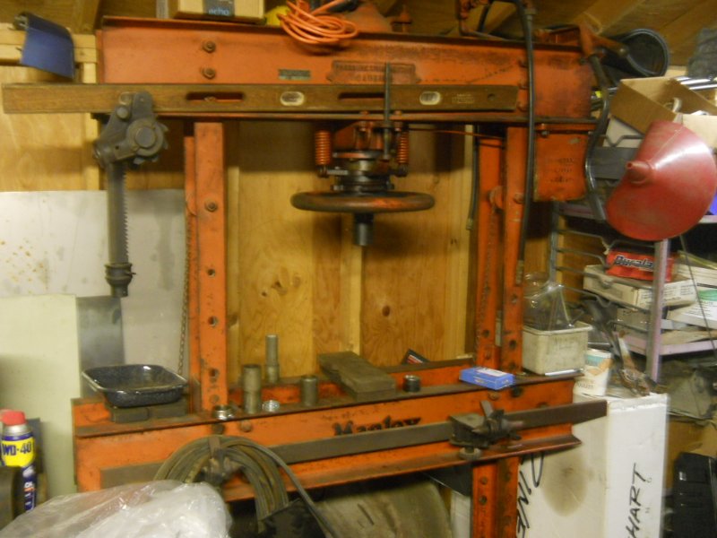

You can never buy to big of a press if you have the room. I would look on line at upcoming auctions or Facebook. I bought a 1934 year old 40 ton Manley at an auction many years ago. The thing still works great and you can still get parts for it. Came with all attachments.
the 12 with be more than adequate for any of the suspension stuff and bearing work. while the new HF 12 is a little more lightweight than my 20 year old one, it'll be fine. if you plan on anything heavier work wise or have aspirations of converting it to a press brake, then get the 20.

What is nice about this style you spin the handle and it screws the spindle out to the job. Your not waiting for the jack to come down against.
Steve is looking for one with a floating head like this preferably a higher 60 ton air over hydraulics. We just missed one on Facebook for $300. If I get a chance I'll get a video of the press in action. That screw can push a bushing in without the hydraulics. You can lift the table up and down with a 1/2 inch ratchet

They are a sweet old press, love to have one.

I bought the HF 12 ton, used it for a few years, and replaced it with the HF 20 ton.
Technically the 12 ton is more than enough to do anything you’d need to do on one of these cars. I found though that when you really push it, there’s enough flex in the different parts to put some side load on your work, which can cause things to bind up.
The 20 ton has a heavier frame and I haven’t had any issues with it flexing or distorting when using it for the same stuff as I was using the 12 ton for.
Ultimately I was always able to get the job done with the 12 ton, but the 20 ton is just smoother and easier to use. Which has kind of been my experience with most HF stuff, you want the rating of the tool to be at least double what you actually think you need it to be.

MAN, they had their thinking caps on when they drew that out!
I really like the old school "kit level" that lives on top of the press, too!
I bought the 6T HF benchtop press which is so short to be mostly useless. So I bought angle steel and gave it longer legs, now it's done everything I've thrown at it.
I bought the 12 instead of the 20 because it had to fit in a spot the 20 wouldn't. It's always done the job but doesn't exactly install confidence. I just used it yesterday to press a wheel bearing out of a hub.

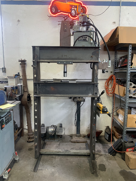

I built my own... 40 ton, floating ram, 36" wide bed, 8" throat, 12" stroke... I can destroy pretty much whatever I want.... Quickly & effortlessly...

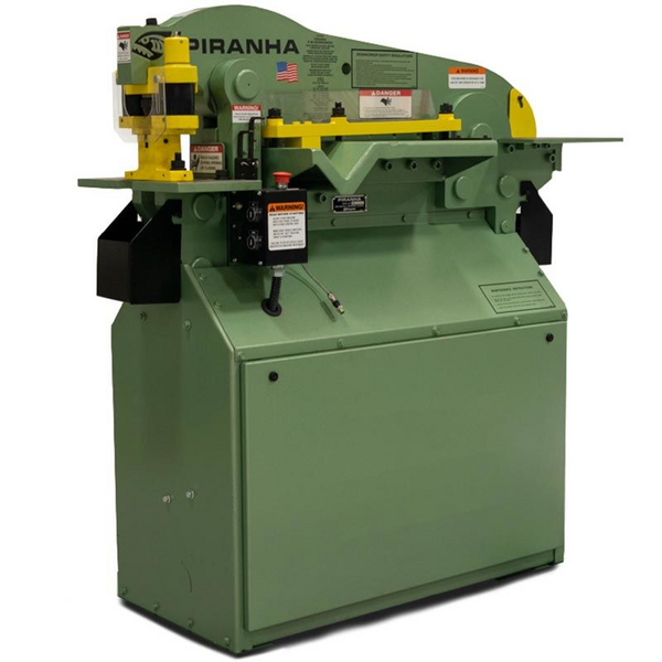

P50 Piranha Iron worker will be nice in the fab shop. Can't find a used one locally for a good price. New $20,000 used $10,000 and up. I have seen some Cheaper but not in very good condition.

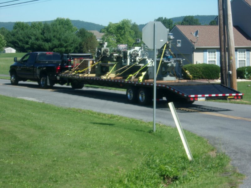

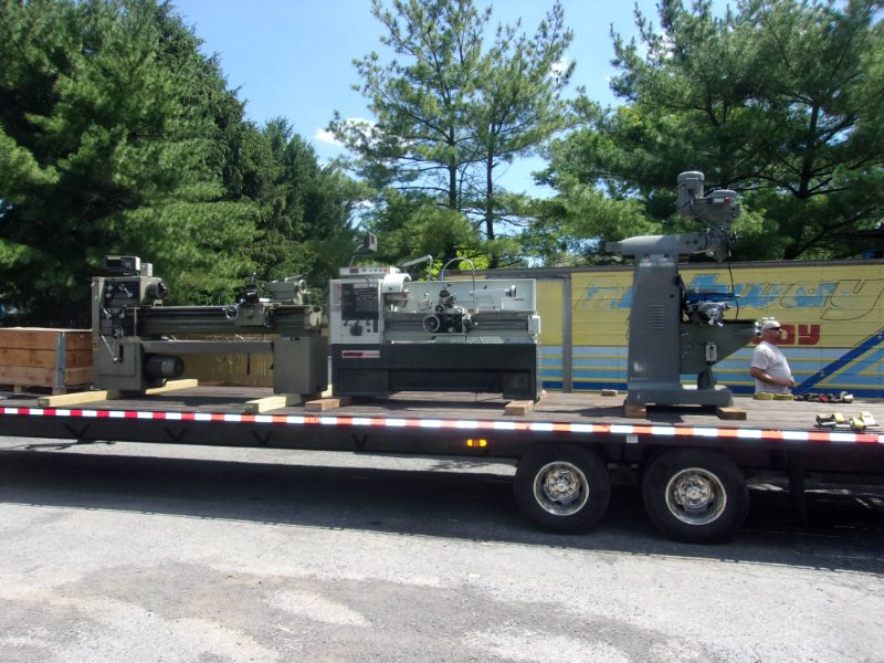

One ting I learned when buying equipment is be patient and watch for auctions on Auction zip . com.
When they come up for sale you can get things cheap if you have a way of loading and hauling them . Many times heavy equipment don't get bidders unless its a big sale and machine flippers show up.
We got some like new equipment at low prices because we could load them and haul them. Some we kept and some we listed on facebook.

I've had the HF 12T and 20T, but have since graduated to a Dake 50T. Both HF units are fine, but have limitations and flaws. Like @72bluNblu stated, the frame on the 12T can flex, but I'm sure someone who's creative with a welder could beef it up and fix a lot of that.
I did the HF 20 several years ago. Adding a set of wheels to the base angles make it much easier to cope with in my small 2 car garage.
Any issues with the bottom rails flexing because they're not sitting on the floor? I like the idea, would make it easier to deal with mine. Even when it's out of the way it somehow gets in the way. :lol:
