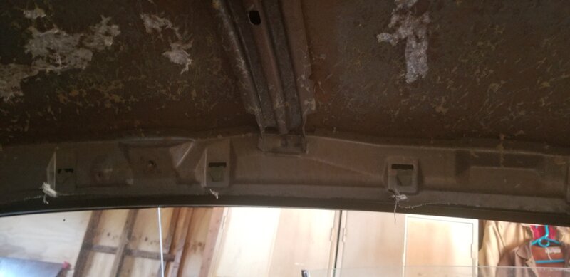

1st pic is of a friend's 67 fb, he welded in a seat belt mount.

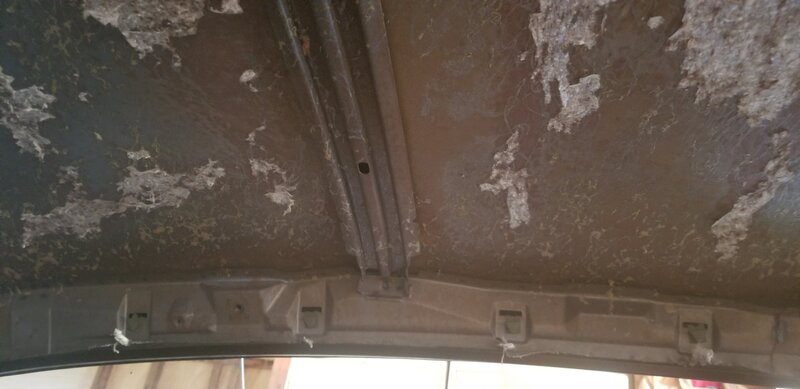

2nd pic is a 68, I stole from another thread.
It appears that in both pics the coat hook is in the same spot, roughly an inch forward of the rear headliner bow mount.
I've read some turn the 67 coat hook into a seat belt mount, however it appears to be in the wrong spot and the 67 bump out for the coat hook looks much smaller, in all dimensions, than the 68 seat belt bump out.
I've also read on 68 and later, the coat hooks were moved rearward a couple inches for the new seat belt mount, however the pics below contradict that.

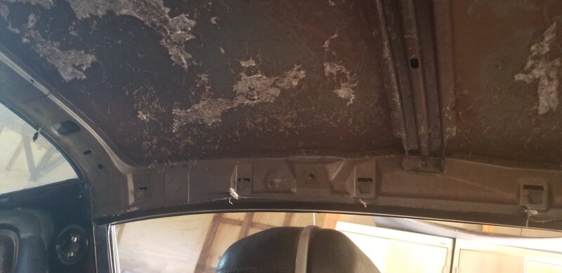

I added my anchors for my 67 so that the strap lined up with the window crease.
I found that i have to reach a smidge further back that what is natural but i like it visually.
