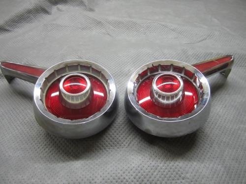

@55crownvic - Excellent job - those look great. I've used the truck replacement lenses several times but never spruced them up with the Ford center piece. I agree these are very hard, if not impossible to find. While not original, '61 lancer lenses will also fit and seem to be more findable, though still tough. To use the '61 lenses you also need the deeper '61 light socket holder. Before I found some for my car (a decade ago at least) I also considered '62 dodge 330/440/Polara lenses as the have a very similar look to the Lancer lens two pieces, red base with a raised add on plasti-chrome ring glued on. Not sure how they compare to one another size wise, but look to be very compatible. Best of luck in your search. Oh, and if your fortunate enough to find a stash with more than you need, buy them all and advertise what you don't need on here as many other Lancer owners need and want these.
Thanks for the heads up. Your tail light lens look great, almost the same as stock. I will try and reproduce them and use the 55 Ford centers like you did.
