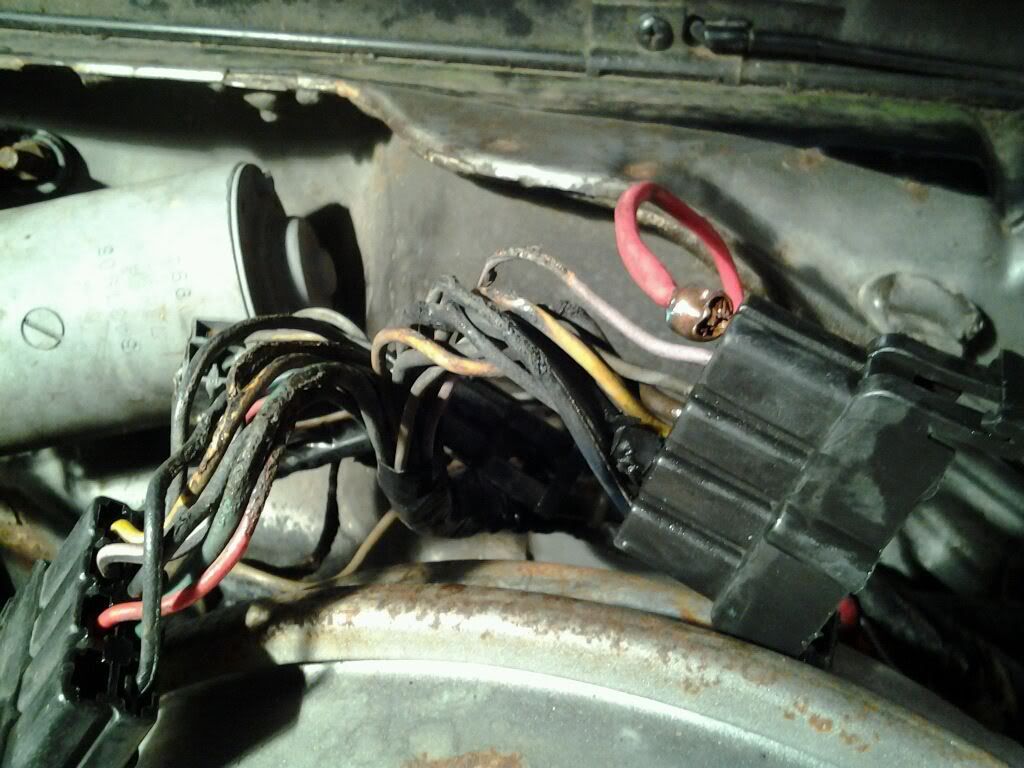

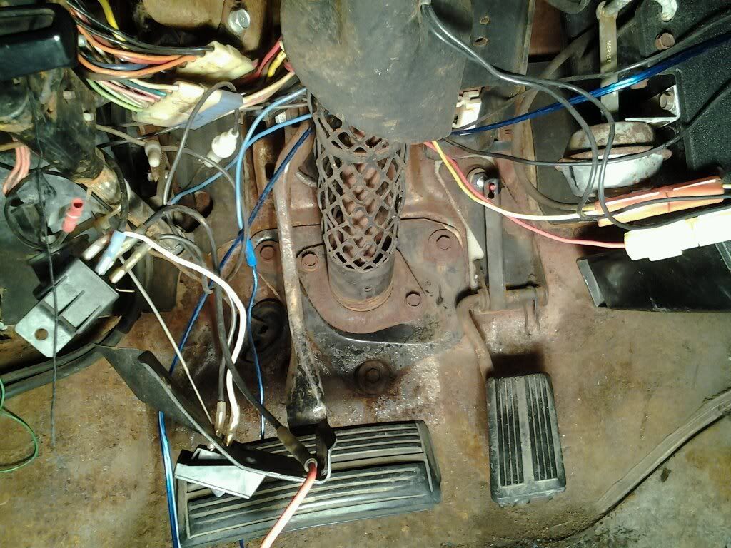

It still didnt run right, so i was pondering the wiring and the ugliness of it, and decided to get back to basics, i ripped all the garbage wiring out, MAN, the previous owner must have been a fireman, because he was getting ready for lots of practice.

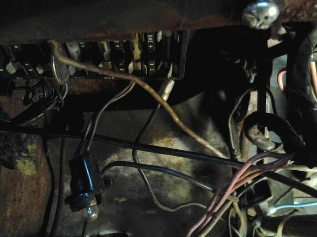

I ripped the radio out that was in it, the power came from a spade connector jammed inbetween a fuse, and a quarter was jammed inbetween another fuse WTF????

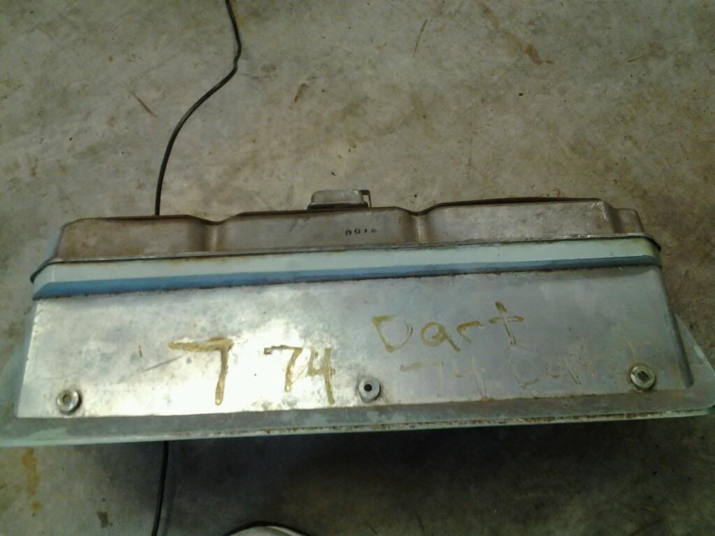

I took the cluster out and cleaned up the grounds and the terminals on the ammeter, and attached the wires to a single terminal since it looked like the other had been fried.

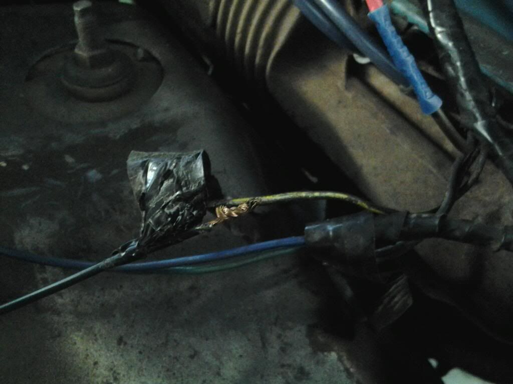

I replaced the two coil wires, they had just been twisted together at a splice, jeez... I replaced the neg and pos battery cable, starter relay and added a alt bypass wire from the alt to the starter relay.
I cleaned up the neg ground on the block and added another ground strap from the rear of the head to the heater motor. I have a heck of a spark now.
