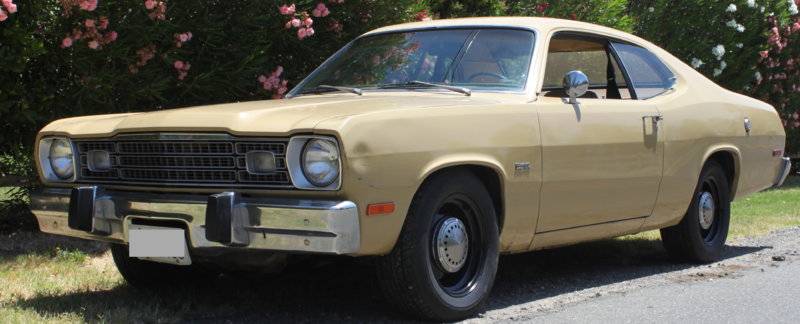

This is my Duster with 225/60/15's on 15x7's with a 4.25" backspace, and that was with the BBP 73+ disks which widen the track pretty substantially vs the SBP disks.
