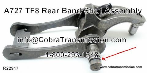

Here's the pin O ring in the first pic and where the pin sits in the trans in the second pic.
