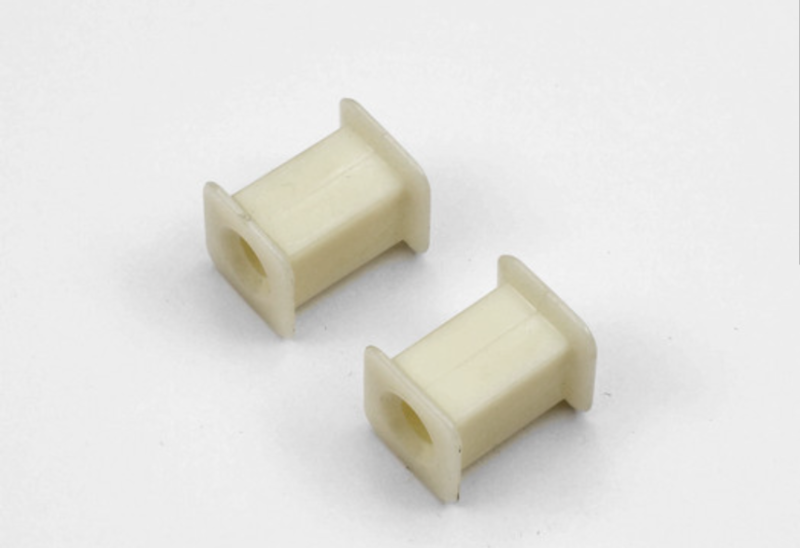

You have these on the hinge end of your springs, correct.
Yes, The Nylon blocks are present.
