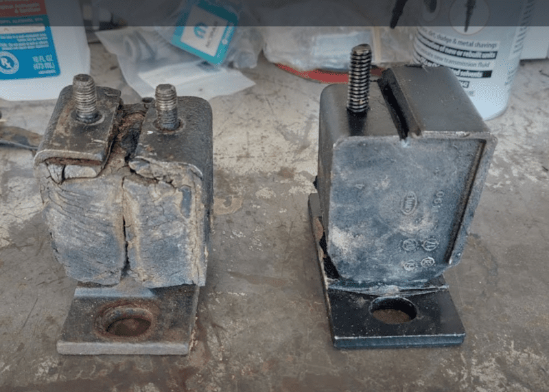

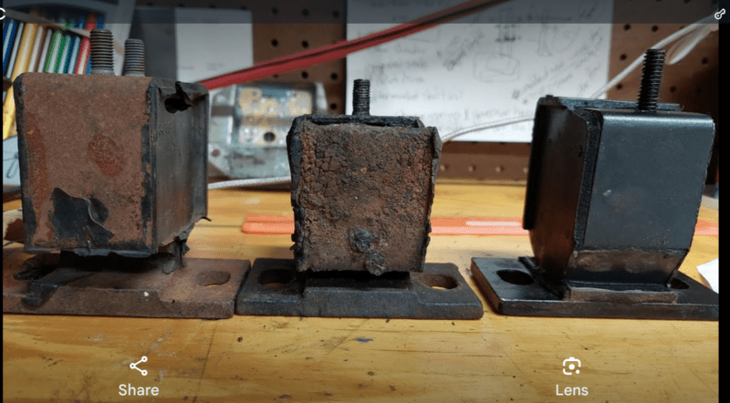

I hate to come to the well twice in one day, but I’m having trouble finding the correct transmission tail shaft mount for my 65 Dart 273/904. Rock Auto, AutoZone, O’Reilly, etc all show the mount as having one stud mounting it to the cross piece. I found an NOS mount like mine on ebay - for $100. I’d rather have something that has rubber that’s not 60 years old. Thanks for any help.

You shouldn't need to drill a hole if you have the early A cross member. But yes, the single stud mounts are the same otherwise.

I’d appreciate it. I’m sure the single-stud would work, but it would bother me everytime I looked at it. There may be some urethane mounts available, and I’m looking into that.

either way both mounts work
and if you really want to, you can probably fit a later spool type if you can find a post 73 bolt in cross member and don't mind chocking it with washers at the indent used on earlier cars to stop you mounting the original the wrong way round.

The one on Vixen has two studs. I have another on the shelf. The rubber isn't bad, but it does have some surface cracks, of course. I don't know when they went to just one stud. The one stud mount will work just fine, though.
If you have the original double, can you just remove the 2nd stud plate and swap it onto the new rubber?
The problem there is, the metal is vulcanized to the rubber. While you could probably get it off the original, I don't see how in the world you'd ever get it to stay on the new one. Plus, you'd probably tear up the rubber in the new one getting that plate off. I'd just use the single stud mount. It's really much ado about nothing.
Agree, the engineers obviously figured out that one was sufficient.

It cannot go anywhere. But If I modded the mount like you're talking about, I'd still want the piece with the stud attached to the rubber. I wonder if something like Liquid Nails would work clamped in a vise until it cured completely?

Liquid nails or something of the 3M automotive adhesives line. Vibration resistant, able to flex
