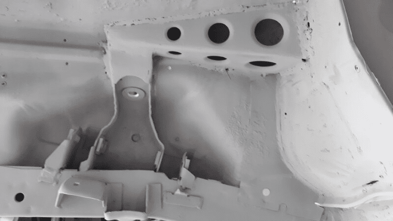

Hi all, i have a 73 Duster that im converting into a 71 model, i bought the inner fender braces from a swap meet and of course there are no instructions in the box, does any one have these instructions or would someone post some detailed pics of their installation. Yes i checked the cartool website and they only have pics of an E body kit, i also called them and they said they would try and find some instructions for me but i cant sit and wait for that. Any help would be appreciated... thanks Rich
Here's a picture on a dart. Hope this helps
honestly Al, my welding is a little better than that, but not much better... im practicing though...heheheh
That's good. This was on a project car I bought, had to go over it a bit. But you get the idea !
Thanks Al, I get the idea, it is the long piece that ties into the shock brace that giving me questions.... it appears to be too far away from each other to get a good weld, im trying to keep as many contact points as i can....i will mess around with it more today. .....Rich
