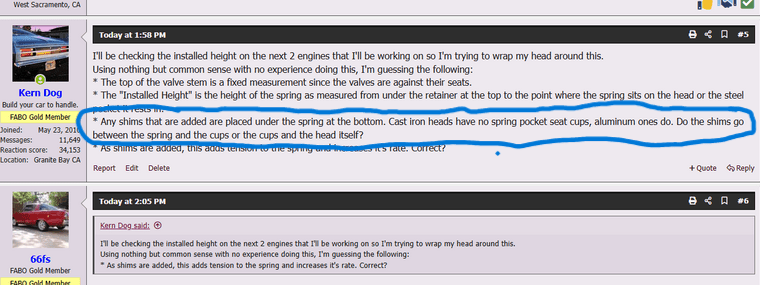

Using nothing but common sense with no experience doing this, I'm guessing the following:
* The top of the valve stem is a fixed measurement since the valves are against their seats.
* The "Installed Height" is the height of the spring as measured from under the retainer at the top to the point where the spring sits on the head or the steel pocket it rests in.
* Any shims that are added are placed under the spring at the bottom. Cast iron heads have no spring pocket seat cups, aluminum ones do. Do the shims go between the spring and the cups or the cups and the head itself?
* As shims are added, this adds tension to the spring and increases it's rate. Correct?

How about the question that is circled in blue?
Do the shims go against the surface of the head with aluminum heads or between the spring and cup?
They go between the head and the spring locator/cup. At least that's how the ones I've had were installed. It makes sense to me since the locator is probably going to be thicker than the shims used. I'd want the thicker piece against the spring.
I was curious about the shim placement only because of how it might wear on the aluminum.
You never want to have thin shims [ 010 - 0.015" ] in direct contact with the spring. They can get chewed up. If you have a shim 'package', say a 040 & a 010 together, put the 010 under the 040 & all good. Alum heads use a cup or locator for the springs. Put the shim under these. The shims will not be damaged, even if thin.
