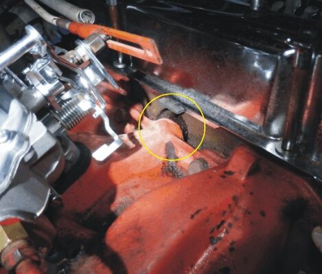

What is this open cavity in my 318 heads?

What is this open cavity in the heads of my 318, and should I be concerned that it's not covered by a gasket or the intake manifold? (see area inside yellow circle)
It's a semi-circular cavity, about as wide as my pinky finger, no idea where it goes, what it's connected to if anything.
Yes heat relief, the hot exhaust gases flow through just below those openings.

Prevents a hot spot under the valve cover that can cause oil to coke. And as others have mentioned, a place for throttle rod clips to hide.

It was an attempt by Chrysler to ‘shave some weight‘ for fuel economy purposes back in the day. Then they got serious a few years later with the Feather Duster/Dart Lite.
