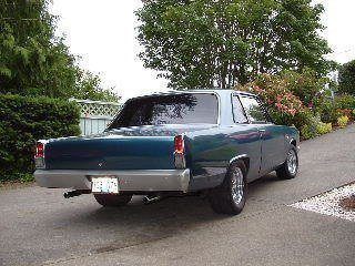

On my 66 Vart I have 195-70-R14 tires on the front and 225-60-R14 BFG's on the rear. I've also installed a set of 70 Duster 340 springs which I had re-arched and had an extra leaf added, and a set of 6 Cyl torsion bars up front. If memory serves me correctly, I have the bars adjusted to give me about a 2" rake to the front, measured at the front and rear of the rockers. With the sort of low nose and high rear deck area of these cars, I think the slight forward rake gives them that mean Mopar look that makes the competition think twice about toying with you at the traffic lights. I'd give you an exact measurement but my Vart is on the rotisserie right now and the figures may be off slightly. :)
