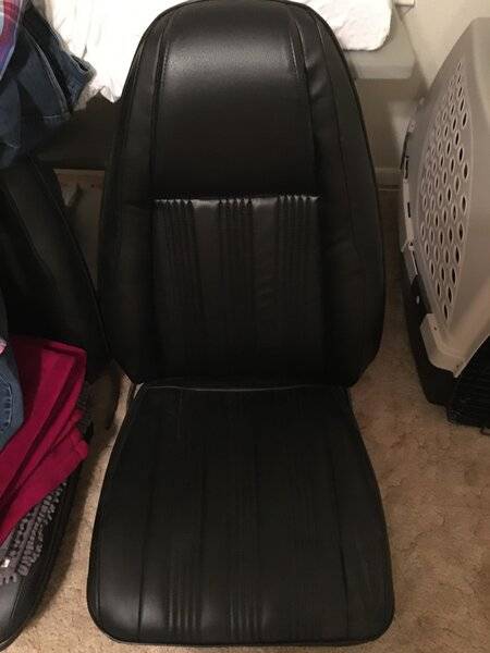

I had the upholstery shop make those foam pieces. They did a good job of it and I did not chop up the high prices e body pieces
