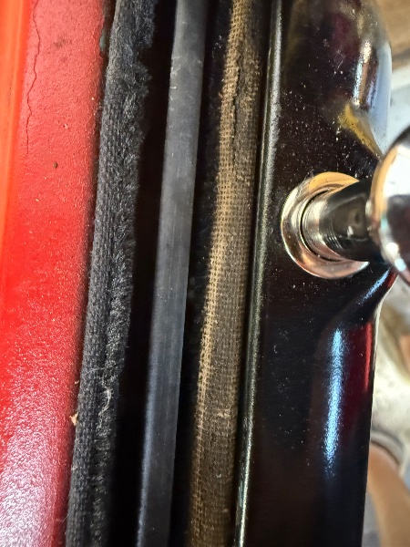

Is there any source of window felts or "whiskers" that are actually functional? Ive purchased "Repop" brand from classic industries and "Topcat" from Dantes and they are identical to each other but are much thinner than the originals which leave about a half inch gap between the felts and the glass which basically renders them useless. Picture attached shows the difference between the original and the topcat I just installed.
Both those pics look like orig?

The one on the black side (interior) is original and the material behind the felt is much thicker than the topcat installed on the red side (exterior). The new felt doesnt touch the window at all. I can fit my fingere in between.
Honestly i heard topcat is the best which is why i ordered them after the cheaper ones didnt touch the window. But the ones I recieved were visually identical to the “repop” brand that were about 60 bucks cheaper.

Just a follow up. I contacted classic industries who I bought the “repop” name brand ones through.
They had Repops reach out to me and they then sent me three different thickness felts so I could mix and match to get the correct fitment.
The thickest of the three on both the inside and outside were very very close to the original. Maybe just a tiny bit too thin still but close enough to make me happy.
