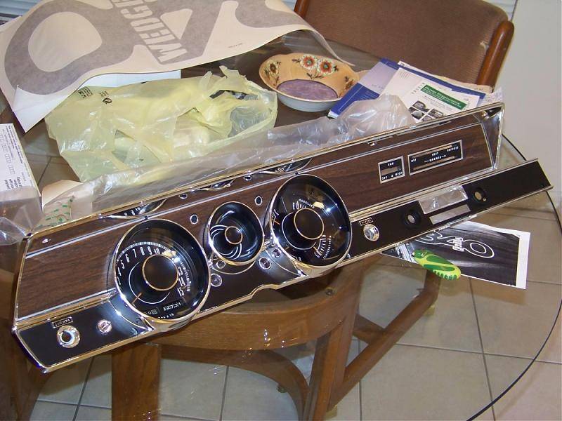

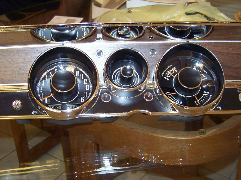

I can do these far cheaper than a repop and about 150 less than others can. I only charge 375 for complete deal. dash lenses and glove box panel. No problems with paint adhesion either.
I just recently did one for Ryan426 and he was very pleased. He posted it here a short while back.

Please clarify for me what you're offering here..........
Are you sending the units out to be replated, then finishing the detailing yourself, or are you actually offering the plating as well?
I like what I see in the picture.........Let me know more details. Doc 8)
Thanks, I'm offering the plating as well. No time is wasted on sending them out. I can usually have a dash completed and returned in 3 to 4 weeks.
yep very nice job i was pleased on how it came out and only a fraction of wut others charge i didnt need to send out my gauges mine were fine, and i just bought the woodgrain and put it all back together and i think i had mine back within 3 weeks :-D:-D:-D
