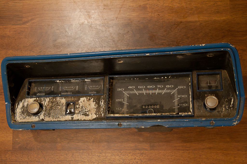

Pulled the gauge cluster out. The housing itself is in surprisingly good shape, but the finish is shot. The speedo is broken; the needle broke off. I'm surprised that a car this old, with a factory manual, didn't have a tach. I know they're not necessary for driving a manual---I never look at the tach in my Jeep---but it seems odd to not have one.
Yes, the needles are blue. It's odd. I think that might be the factory color. I'm not sure yet.
I think I'm going to go with aftermarket gauges when everything goes back together. There's really no use in sticking with the factory gauges, since all worth in the car from a collectible standpoint was killed long ago. I had originally thought about building my own gauge housing, but then I stumbled upon these guys: http://www.redlinegaugeworks.com/products.asp. The second item is an ABS plastic drop-in instrument panel that will fit my dash's opening. This is awesome and takes care of my biggest worry about going with aftermarket gauges.

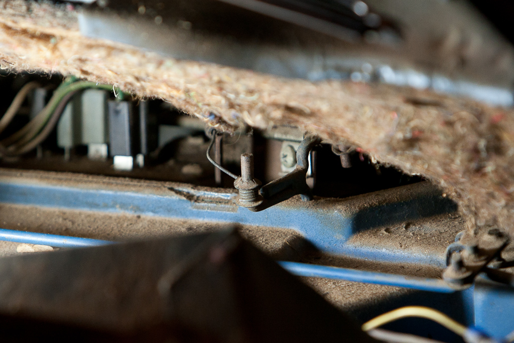

Does anyone know how to remove the temp control cable from either the dash/control end or the heater box end? :( That's the only thing holding the dash in the car.
Dash is out. :)
The temp control cable is retained by a disposable ring that just slides over the post on the bellcrank. Then you remove the bracket that holds the cable in place...Requires a Phillips screwdriver. Pretty easy. 7071DartGTReg cleared this up for me. :)
That's the offending cable/clip.

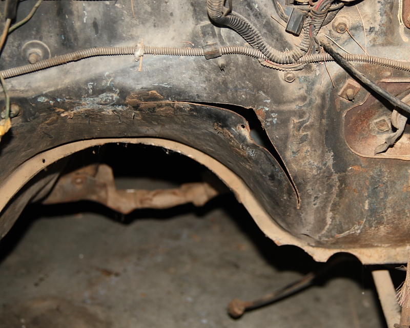

I took some pics of the damage that leads me to believe the car is bent. First, the tear in the firewall.

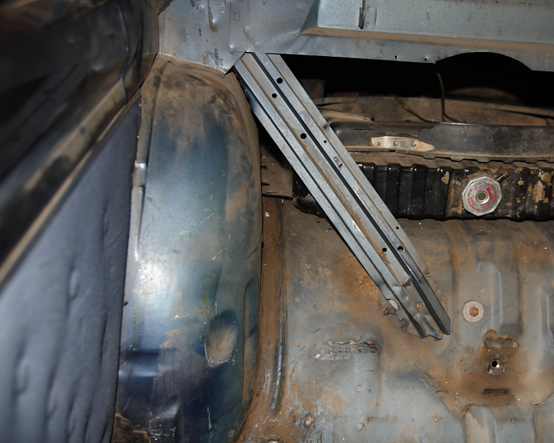

Second, the package tray brace being bent.
These two things, plus the panel gaps being larger on the left side of the car, make me think something bad happened. Thoughts?

that firewall damage looks man-made. wondering if somebody took a shortcut to get to the bellhousing bolts.

Second picture possible tranny explosion....third picture something in the truck might have slid into it.....fourth looks like hacking for front sump oil pan clearance...JMT
What I originally thought was a tear in the firewall looks to be a cut, now that I go look at it again, and it's bent out towards the engine side of the firewall. Maybe someone did cut this for access to the bellhousing bolts...But those bolts aren't hard to get to in the first place.

Not sure about the package tray brace damage. That wouldn't explain the outer side of the brace being folded where it's close to the wheelwell. Any ideas about that one?

That brace looks like mabby some one hit the brakes hard and some thing in the trunk slid up and hit it? Hard to say. Like has been said I would just take some mesurments and see if it is strate or not. No reason to take it to a frame shop if it is not bent.

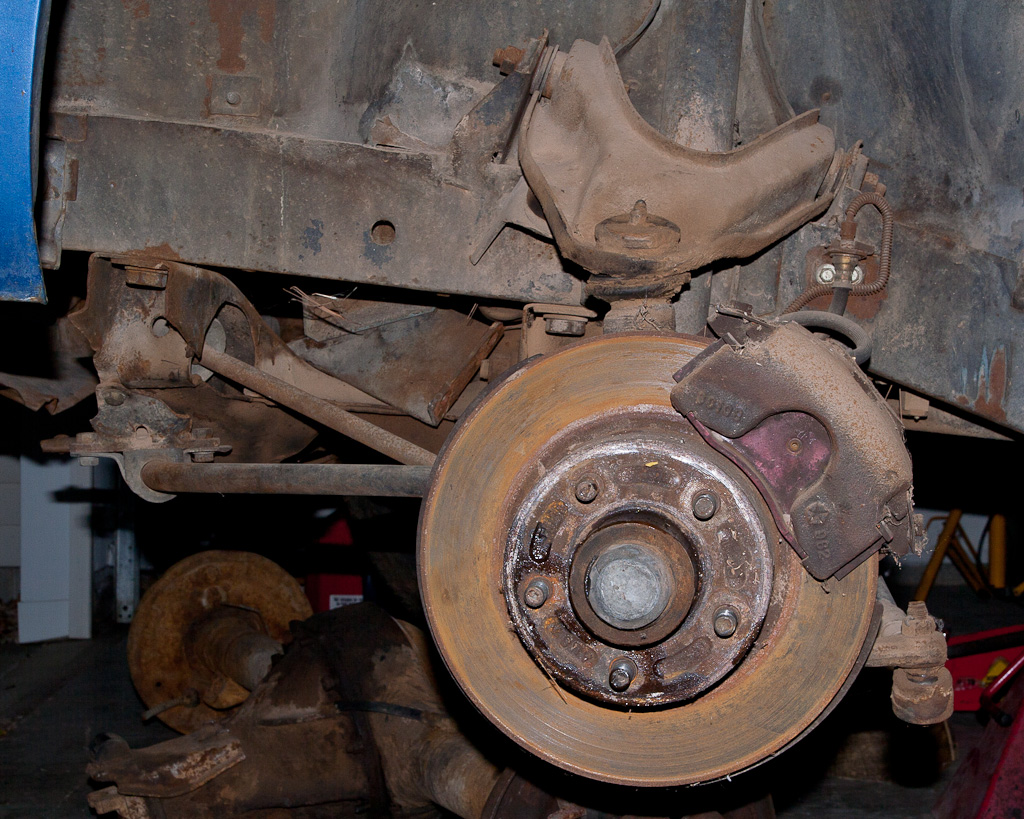

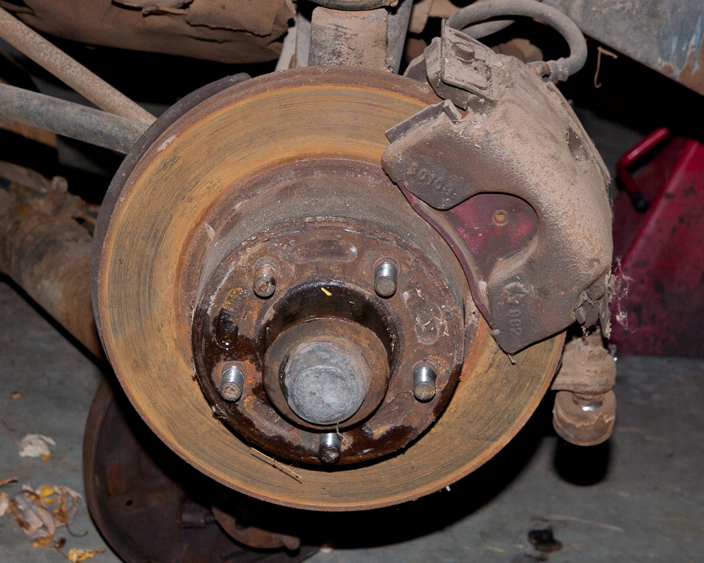

Pulled the left front wheel off and the car appears to have the big-bolt-pattern '73+ disc-brake setup. Can anyone confirm this from a few pics?
Thanks for taking a look.
It doesnt look like SBP KH brakes but to be sure you should measure from the center of one stud to the outside of the 3rd stud. Plus SBP would have used 7/16" wheel studs where I do believe the LBP used 1/2" wheel studs.
I'll try to measure stuff tonight. The front of the car has Outlaw II wheels and I'm not sure those were ever made in five-on-four.
