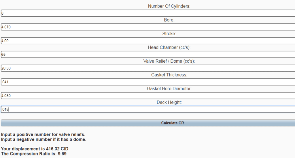

Here is a picture from a compression calculator @rumble put on here for me. I looked on this forum and seen that the deck height is probably .018 so I added that in.
I looked on summit for the gasket bore diameter and chose the 4.080 because I didnt want overlap into the cylinder, at least that is what makes sense to me lol
The compression seems low to me for what I thought I want. Did I miss anything guys?

Its 4.180, not 4.08, and thickness is 0.39
With a dished slug and eddies your going to come out just short of or around 10 to 1.
Nothing wrong with that for a driver at all. Will still make gobs of torque and horsepower.

For 91 pump gas it's safe to be around 9.5-10 to 1 compression. That's a 20cc-18cc dish with a 4" stroke and "65cc" heads (67cc measured). Cam doesn't seem like it's going to be that big to bleed off compression.
