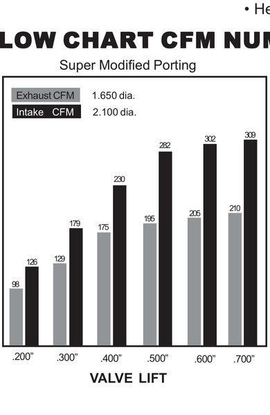

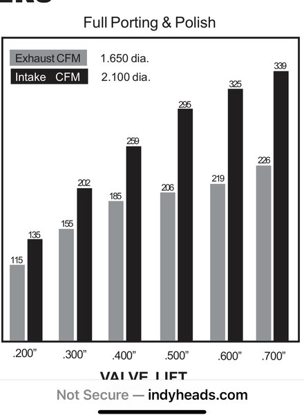

Found the specs on the CNC ported 360-1 heads
[/URL]
But he didn’t say they were cnc’d heads. Here’s Indy’s heads in different versions but I wouldn’t put a lot of faith in Indy’s flow numbers. Hopefully that will change with the new owners. If you take your heads to Joe blow down the street fully ported may mean he hit them with a sanding roll.
My 360-1s (which I didnt port, but have definitely been nicely done) were I think... if I remember correctly, high 320s at .650
Very nice I haven’t looked at my flow sheet in awhile but I know they were in the 320’s too. Now that I’m capable of doing competition valve jobs I’ll be hitting them again for my 422. I think they will hold a bigger valve size. Hmmmm

I found out yesterday that the heads I have, which had been ported and hand blended barely flow 239 cfm (intake) @ .600, and 181 cfm (exhaust).
These are the famous Procomp heads ( that btw explode ).........
