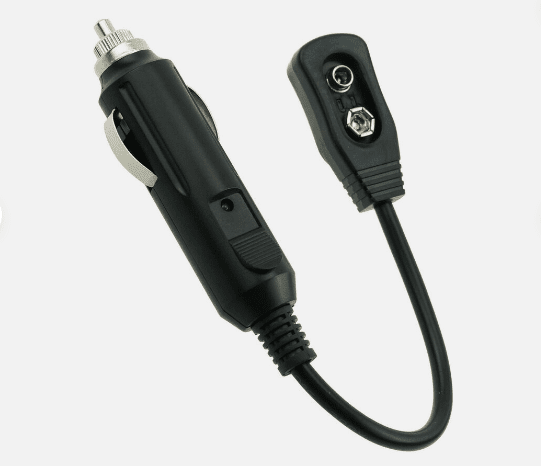

Couldn't you just throw one of these in your glovebox with a 9v battery? Or use a NiCad or Li-ion 9v battery on it and just leave it plugged in?
Simple, and works for me for saving radio settings when I have to pull/disconnect the battery.

That's basically what I had in mind. However I would like it to be "hard wired" , and I think if using a diode The battery would stay charged, but not discharge if the main battery had a problem. Also I was thinking even if the 9 volt battery was enough voltage for the computer, I would be concerned that the difference between the 9 volts and 13+ charging voltage might be excessive.

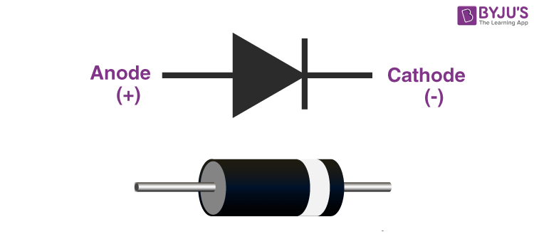

I no of no simple way to do this, other than to find a small lead acid battery, which you might be able to do. In that case you could use 1 diode in the main vehicle line. You would want the banded end of the diode towards the unit you want to back up and the opposite end coming from the vehicle power system.
Anode coming from vehicle system, cathode feeding to the backup unit. Backup battery connects on backup unit side of battery.

Think I have this figured out. The "keep alive" circuit will be powered by this aux battery (don't need this large but is the smallest SLA i can find) https://batterysharks.com/12-volt-5-5-a ... ttery.html The positive of this battery will be connected to the vehicle battery through a 1N5404 power diode (400 volt@3 amps). The negative to ground. That will allow the vehicle to keep the aux battery charged, but the diode will prevent the aux battery from discharging through the vehicle electrical system. easy/peasy simple and inexpensive.
