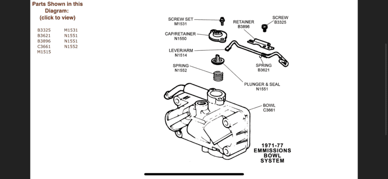

The little linkage you put a “?” next to is a vapor vent for 71+ emissions reasons.

That small linkage in question is for the bowl vent. Every factory six pack had this, two different types were used.

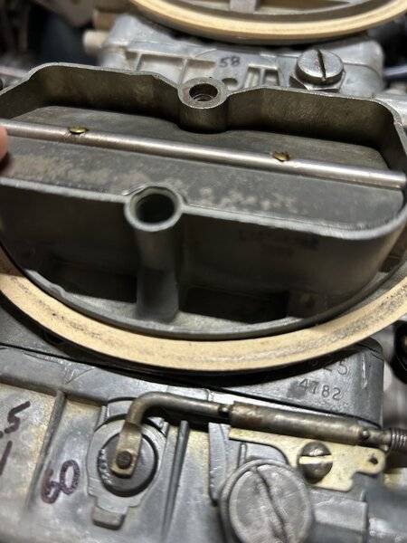

Is the choke plate supposed to be flat, or bent? This one is bent, and has a wee dent on one end.
The center carb has a bowl vent only, no tube for emission venting.

I made another mistake, the choke plate does have a slight angle bend to it.
It’s hard to show in a photo but it is angled some.
