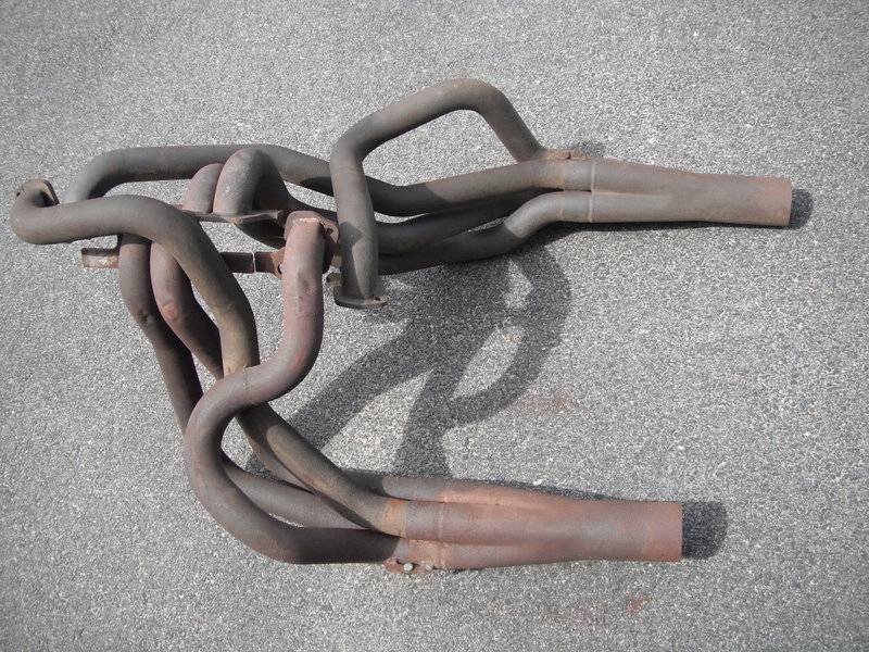

These are a race oriented header with slip fit tubes going between the collector and the head pipes. I own a set of these and would not recommend on a street oriented car. I believe the tubing might also be lighter gauge on these than regular street headers. Collectors have no flange for mating to exhaust system, although band clamps could be used. One tube on each bank goes through the wheel well. Power steering can not be used with the 5303. These are a tunable race header, unless you own a set they may prove difficult to obtain as they have not been made for years.
For what it's worth, my W2 head 408 stroker uses 15/8 to 1 3/4 stepped headers in my street Dart. Dynoed at 547hp.
It is my opinion you would be better off with a good quality set of street headers. I'm not saying the 5303 cant be used on street, I dont feel it is the proper application.

Here are my headers, this is the photo the seller provided me when I bought them.

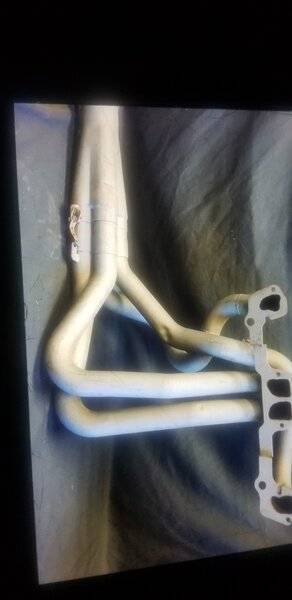

Here are the pre 67 A body small block headers..
These will go for about 250 dollars. If they had just come to me as ones they would have been 200 but I have to pay gas, expenses to get there etc. So I'd like to get my money back at least.

Three are the ones I picked up, I'm not sure though if they will go thru the fenderwell...
He said no (had them in a 71 Duster) but I think those A BODY cars were ok but older (69 & earlier) they look like they will go thru, but he said no thru go on the bottom.(good words)
