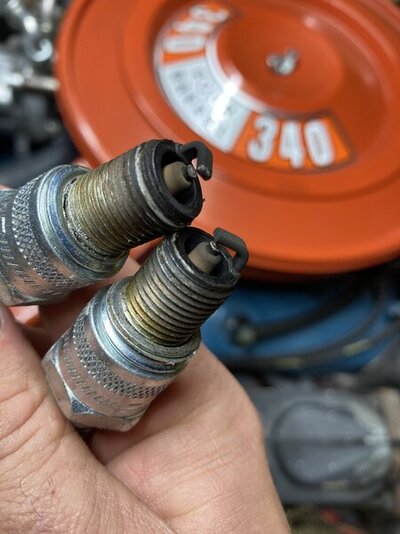

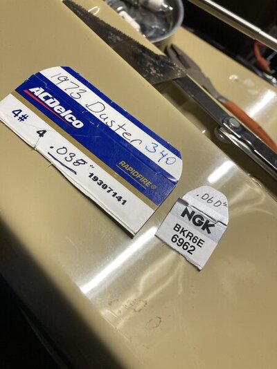

I switched to NGK BKR6E at .060” gaps as suggested. 73 340, stock piston. Firecore 8mm wires, MSD RTR dust., Blaster 3 coil. QFT Slayer 750, 224/224 @ .050, 110 LSA, SFT.
AC Delco’s at .038”, 1,000 miles.
I had the owner of the current engine I am building, buy new NGK plugs for it. They came pre-gapped at 060. The NGK part # had a suffix -15, which is the preset gap in mm [ 1.5 mm=060" ].
Man, mine were tight. Like .030”.
I have only idled it with the new NGK’s but I swear the exhaust doesn’t smell like I burned fuel nearly as much. Also, it idles a little smoother. This might just be placebo effect but I do believe there was less fuel smell in the exhaust.

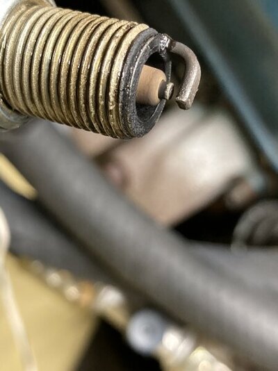

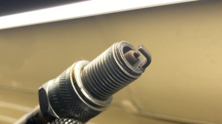

I'll report back with pics of the NGK plugs and a longer evaluation of how it runs with the .060" gap after some miles.
