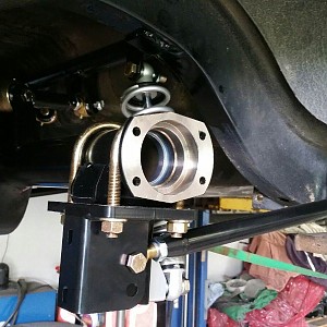

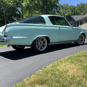

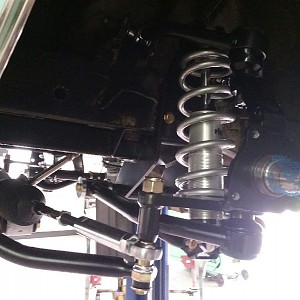

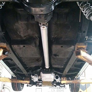

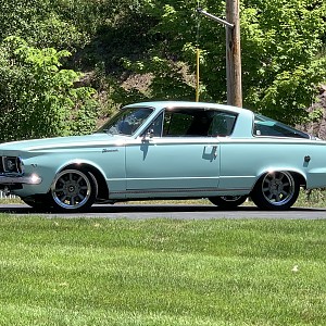

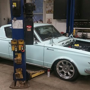

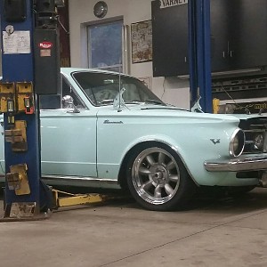

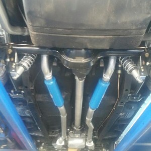

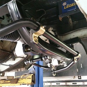

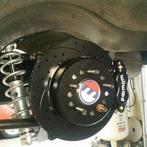

Putting in Reilly front and rear suspension, UsCar Tool frame connectors, 408 and hopefully a 2004R transmission..

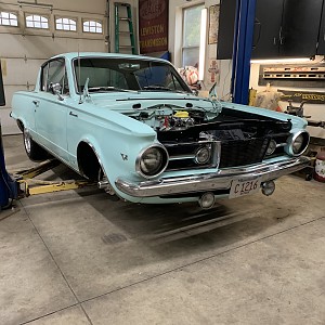

the beginning, frame connectors welded in and suspension trial fitted. Engine should be here by September 1st
Update 2/5:

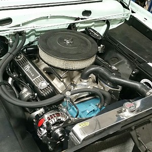

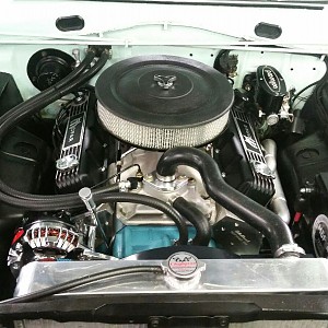

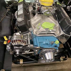

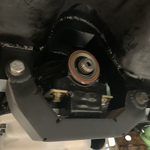

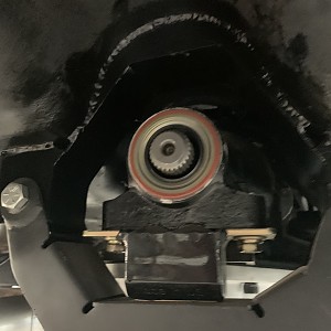

Finally getting close, nothing goes easy on an early a body. Took a lot of work getting the 2004R mount in but it came out great. Getting the headers and starter to play together took a bit of trial and error. Time for final wiring, fuel & transmission lines, and shifter. Can’t wait! Friend Daryl at Crazy Kid Customs has been a godsend!
