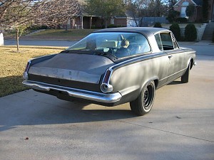

Off the rotisserie and turned into a roller for the impending move from Fort Worth to San Diego. Bunch of quick work on short notice only to be blown apart again after the move. Ah, the trials of life in the USMC!
Work done to date:
-media blasted top and bottom
-frame tied
-primed in epoxy
-underside, floors, underhood, sills, trunk shot in B9 Blue
-B body 8&3/4 narrowed with Strange axles. Chunk is still a 2.73:1 open diff for now
-Mid 70's A-Body disks put in up front
