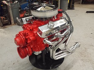

Mild 360 small block.

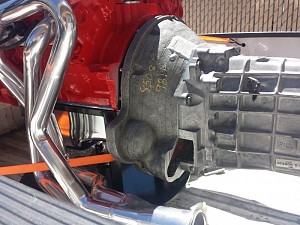

T56 6 speed transmission.

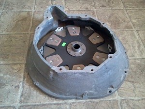

CAD designed and sand casted bellhousing.
