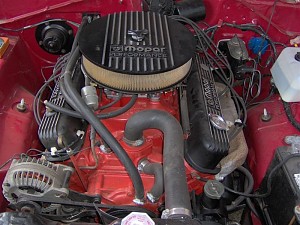

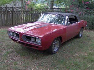

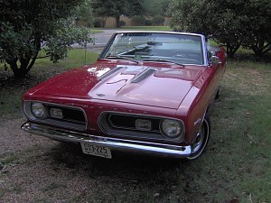

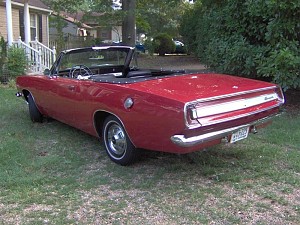

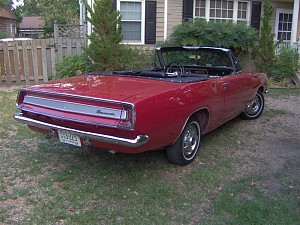

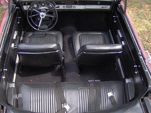

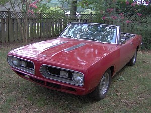

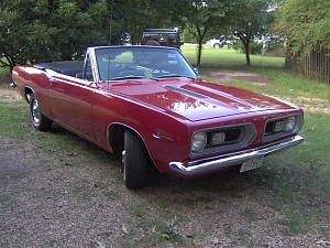

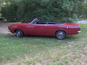

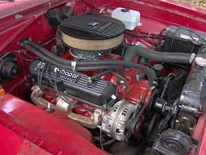

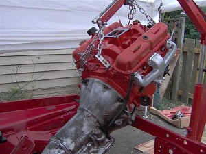

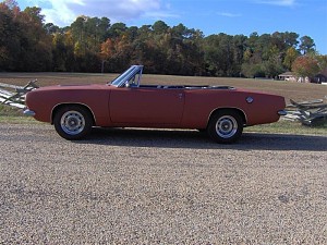

This is my 1967 Barracuda convertible presently being restored. I bought this car with the understanding that the block was cracked since water was getting in the oil. It was a pleasant surprise to find out that the timing cover was bad! Originally this is a 273 with a 2 barrel carb., P/S and A/T with column shifter. The engine`s been rebuilt with .030 over pistons and new rod, main, and cam bearings. The stock 2 barrel solid cam remains. A 3 angle valve job has been performed on the heads...
