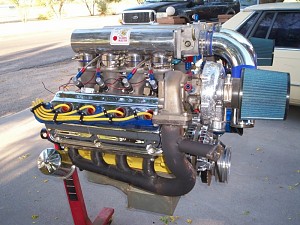

This motor is going into my 67 Valiant. It has been bored .o60" and is now 352 ci. The turbos are Garrett T3/T4 hybrids and there are a pair of intercoolers. The rods are stock, but have ARP rod bolts. I modified the Hilborn injection system to accept TPI injectors that are 72 lb. The ignition is a Joe Hunt mag that I converted to run from a Megasquirt computer system utilizing the MSD 6A box. The cam is a Contrerras roller with Lunati lifters and adjustable pushrods from Hot Heads. The...
