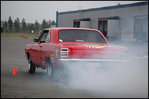

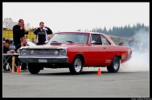

Originaly sold new in sweden. Stock 273 cui engine swaped for a 440cui. 8 3/4 rear end 4.56 gear leaf springs relocated to the frame. 26/10.5 15" M&H ET drag slicks....
Tranny: 727TF, stock 340 converter ~2000rpm stall :sad: much to low.... Cheetah manual valvebody.
Engine: 440cui Stock bore/stroke. 413cui Forged Crank, Stock forged 440 rods, 10.75:1 forged TRW Pistons... mechanic CompCam very aggressive... ~.600 lift ~300 duration. 3/8 pushrods...
