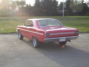

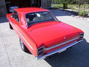

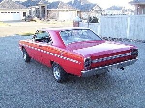

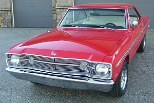

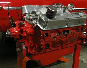

Here's my '68 Dodge Dart
- '72 340 block
- bored .30 over
- TRW forged pistons
- moly rings
- Clevite bearings
- Eagle SIR rods
- Balanced rotating assembly
- MPP 268/272* 450/455" lift cam and lifters
- HV oil pump and rolling timing set
- Late model 360 design heads #587's
- 3 angle valve cut, bowl hogged and blended
- Matched Offy intake.
- Holley Avenger 670 cfm carb.
- HV fuel pump
- 426 Hemi radiator
