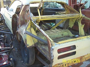

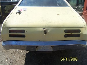

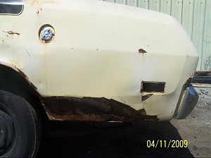

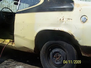

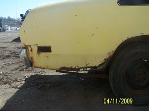

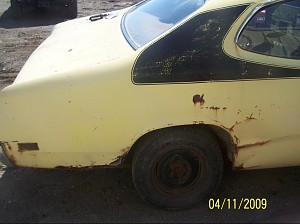

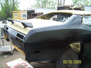

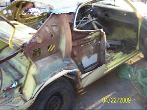

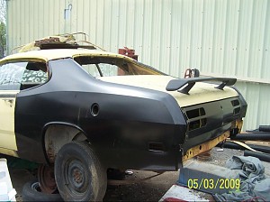

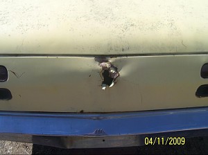

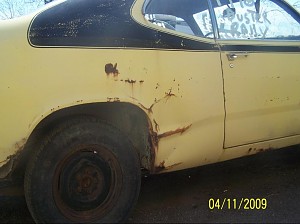

when i got this car it was in real bad shape but it does have the small block k frame and it is a three speed on the floor quarters were dented and roted out drivers side had bondo about 1/4 in thick so far ive got the new quarters and tail light pan lined up and ready to be welded on i have a full floor pan to be welded in and so far i have a disc brake setup for it i have a 72 440 hp to put in it and a 833 over drive the bad news is that i got the 75 duster that was on...
