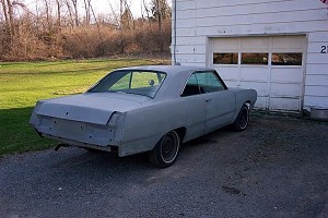

Original 318, 2bbl, A/C, Automatic, Maroon with White Interior
Engine:
318 bored .30 over
360 crank turned down
It comes out to 348ci
10:1 compression
302 heads
Edelbrock performer intake
Holley 650 DP
1 inch phenolic carb spacer
Summit Fuel pump
Summit double roller timing set
Comp Cams 270/270 duration .470/.470 lift
Comp cams Valve springs
Comp Cams Push rods
Melling Std vol. oil pump
Stock water pump
Hooker Headers
MSD Pro Billet distributor, coil and 6AL ignition box...
