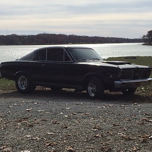

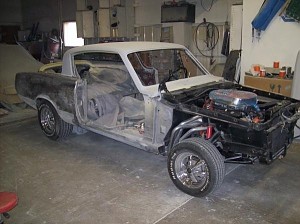

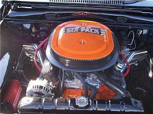

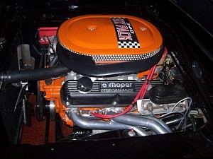

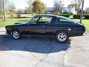

340 bored .040 stroked to 418
Eagle crank
Eagle H beam rods
Kieth Black forged dish pistons
Comp solid lift cam .502 intake .511 exhaust
J heads ported 2.02 valve
narrowed 8 3/4 w/4.10 sure grip Strange axles
833 4 speed w/Centerforce dual friction
Mopar performance six-pack
Billett Specialties Street Lites.
Rear 15"x10"
Front 15"x6"
