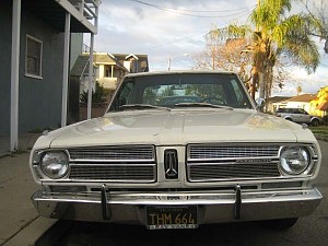

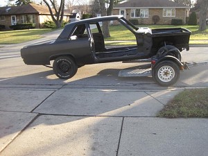

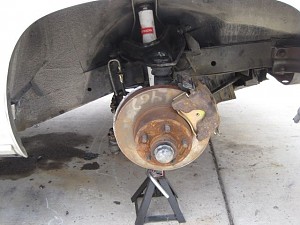

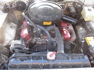

I just picked this beauty up. It's factory with,a/c, buckets,273,904,7 1/4 & original CA black plate car.

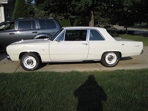

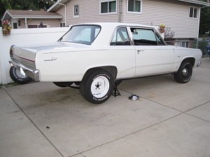

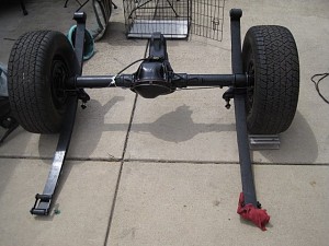

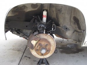

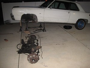

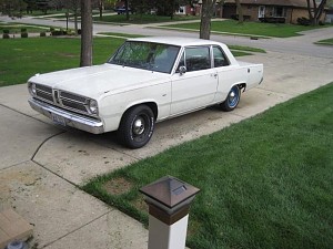

I swapped to the spool k frame & trans mount,BBP Disc brakes,8 1/4,all SS brake lines, 3/8 fuel line,3/8 sending unit,15" wheels & BFG's all around,new KYB shocks.

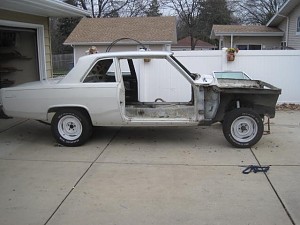

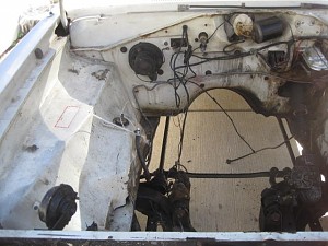

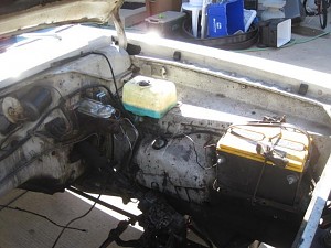

The 3rd wave to go will be the motor,trans & rad

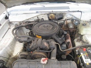

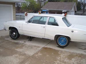

Wave 3 beginning 340,904,tti headers,electronic ignition & radiator

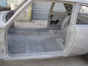

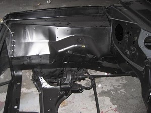

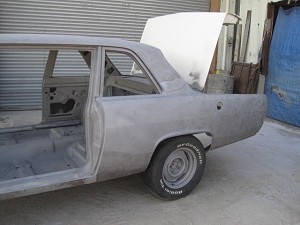

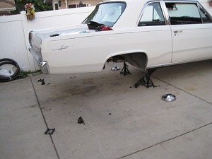

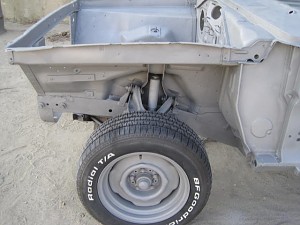

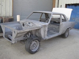

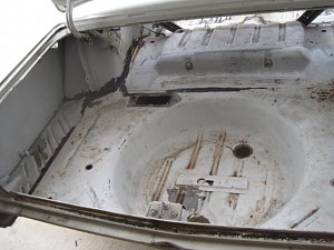

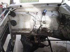

Wave 4) stripped it to a bare shell,had it blasted and primed and installed my 8 3/4 with 323 clutch...
