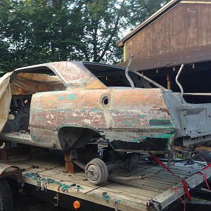

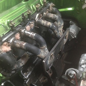

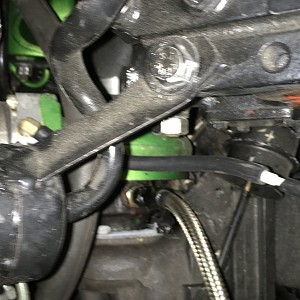

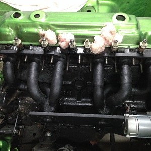

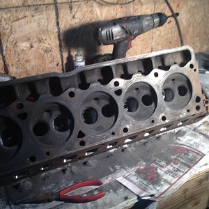

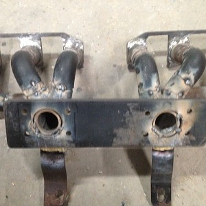

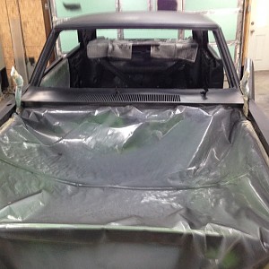

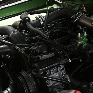

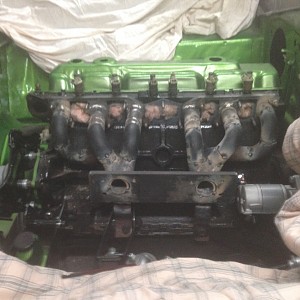

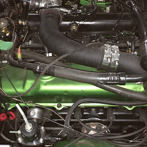

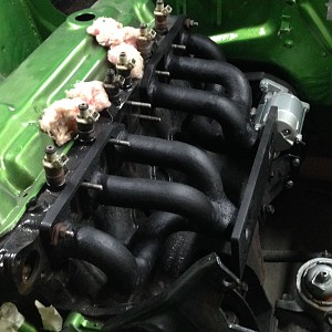

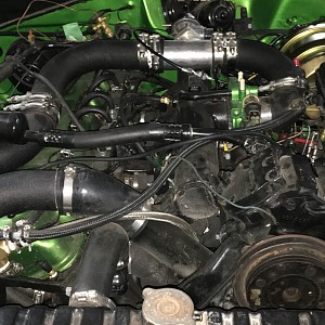

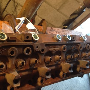

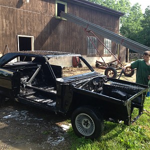

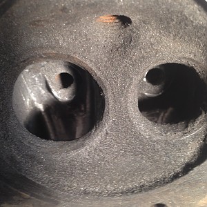

Upgrading a Slant 6, 225 to a twin turbo, batch fired EFI. Milled 0.100 off head and 0.060 off block. 0.060 Over bore. Chrysler Electronic Distributor running GM 8 pin HEI Ignition. Using twin Nissan 300ZX turbos, 1986 Pontiac Fiero Computer and EFI system. Reverse pattern Manual Shift 904 and 7 1/4 Sure Grip Rear End. Bored injectors into head through water jacket.
