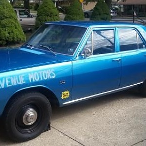

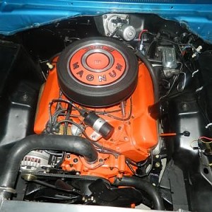

1968 Dodge Dart 270. 40,000 mile original miles. 383 cu.in big block + 4 speed + 3.91 gears = SLEEPER.
Best 1/4 mile time with original 273 auto wad 12.60 at 104 MPH. It had a built 273 with a 557" lift MP cam, 10.5:1 compression, 4800 stall 904 auto, 4.88 gears. After ten years of running that combo on the street and strip the engine let loose. The car set for another ten years. I collected parts and put in the 383 and 4 speed. it now has 3.91 gears. It is a 2 barrel 383 bottom end with...
