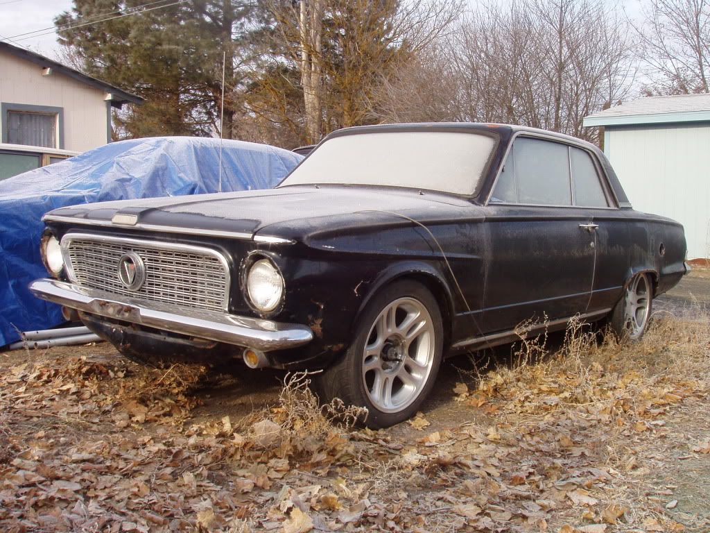

Trying to decide if I want to move up to 17" rims on the 66 cuda. Looking for some pics and info on your rims if possible. Thanks
Here's my '66 Valiant with Coy's 17's sbp. 245/45 r17 rear, 215/45 r17 front. They no the proper back spacing at Coy's for our early a's. Hope this helps!
Later,
cb66
Here's my Valiant with some later model Mustang rims (they were cheap).
The fronts are a 245/45-17 and would need fender mods at the bottom front to work. A smaller tire or different back spacing might help as well. Just an FYI.
