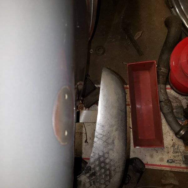

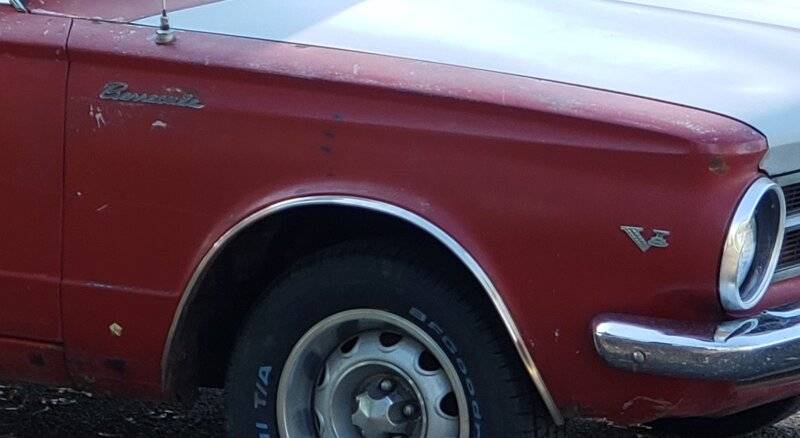

My 65 Barracuda was "de-badged" by the previous owner and although I can appreciate and like the clean body I would like to at least place the fender emblems back on the car. I found a detail shop to make me size correct decals for my front fenders but since the body holes are filled I don't have a good reference to place these decals. Can anyone with a 65 Barracuda do some measurements for me on their fender badges so I can place these vinyl ones in the most accurate location possible? I'd really appreciate it if someone could get me the measurements or post some guide photos.... Happy New Year, FABO!

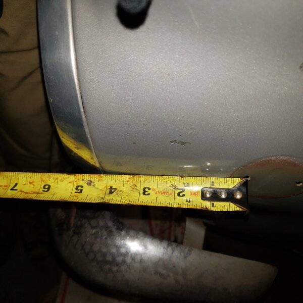

Maybe these pics will help?
My S badges are off and they didn't remove them whe it was painted (?) So nice and clear outlines...height is measure from bumper, from the top its measured from the plane of the hood, front is from the edge of the body before the bezel. Seems to be centered about in line with the bumper support. Great, found a new scratch! :BangHead:
View attachment 1715662668 View attachment 1715662669 View attachment 1715662670 View attachment 1715662671
I was going to ask if anyone could give this too but I'm looking for the Barracuda letter emblems farther back on the front fenders too....do you have those measurements too? THANK YOU

Thanks again, @pishta for sharing this with me. Here's the info in case someone else comes hunting for it! Driver side 3 1/8 from door edge to tail of a in Barracuda , 3 inches down from hard edge of fender to top of same a tail. Same on passenger side to edge of B
