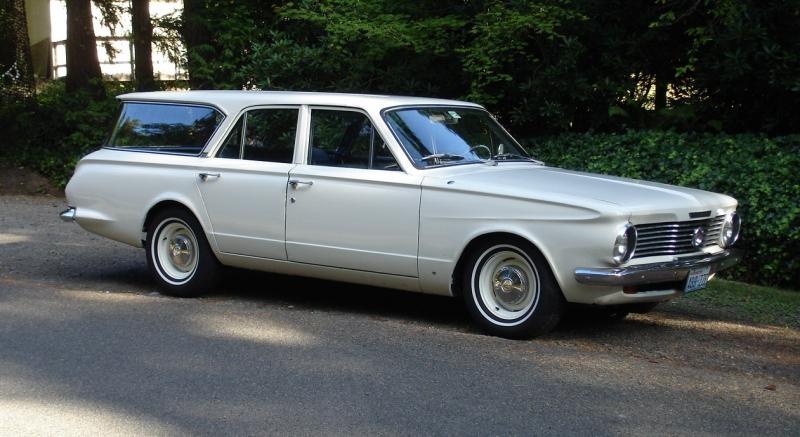

Yes, they will work. I have 205 and 215/75/14's on my Valiant wagon.
