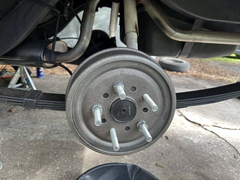

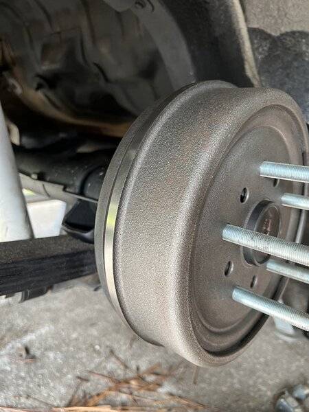

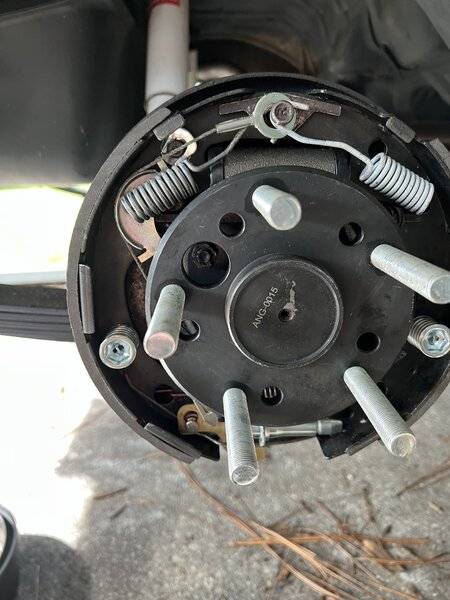

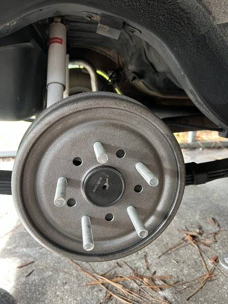

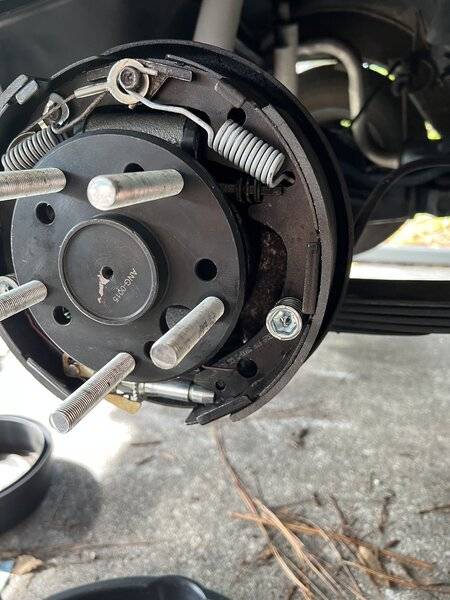

It is a 4 bolt plate. I will pull the axles and install the new ones. I have dual pattern 9” drums to go with the new axles. Looking forward to having matching 15” wheels all round. Thanks for the help.
Finally had time to install the axles.
All is well so far.
The axles and drums were bought from Dr. Diff.

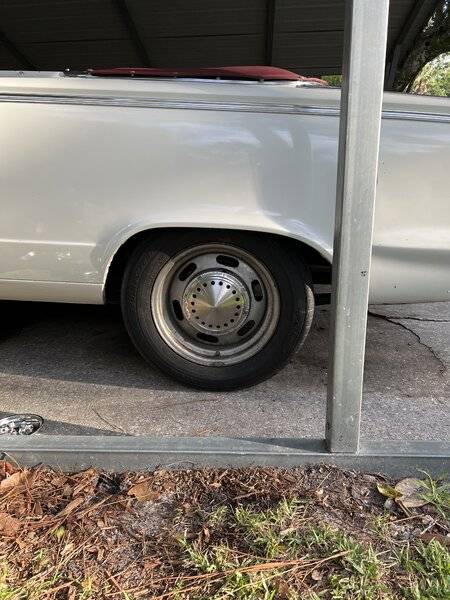

Police wheels on a 65 convertible Valiant.
Thanks
