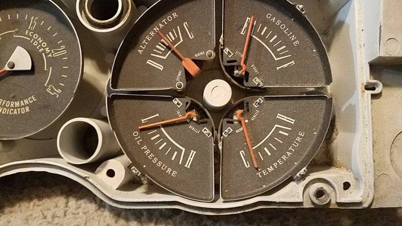

Here are close up images of the confirmed 1968-72 housing, the housing I have circled in red in the first post.
Let me know if the speedometer is a screw in 1968 style.
From my expertise it looks like if this is bolted into my 1967 no one would be able to tell the difference from the gauges.
Do all of the AC and heater climate control remotes look the same from 1967 - 1972?
I'd like to be able to use this instrument panel because it seems as if the gauges are rust free and that being given I would be able to tolerate some sun fade if any after dusting them off.
All 67-69 barracuda gauges, as well as 70+ rally gauges interchange.

Difference in speedo is how the cable attaches ( back view ). 67 uses a collector nut similar to transmission attach method so you should see threads. 68 and later use a plastic clip on this end of the cable, so no threads , just a shoulder for the clip to sit behind.
You'll find that housings and bezels and climate controllers are different. Use whatever gauges you want in 67 housing with 67 bezel in a 67 dash. If my memory serves... there's a one wire difference in the 67 and 68 up a/c controllers also. I think other owners have found a solution for that. Cross that bridge if and when.
67-68 speedo have the same numeral arrangement around the gage face. 67 uses a threaded on cable, 68 up is push on cable. 69 up is different the way the numbers are arranged around the face Formula S is a 150 speedo. All package levels could be ordered with trip odometer from slant 6 to big block. See pic below of gage faces. 67-68 used a conventional tachometer face, 69 up used a sidewinder tach
